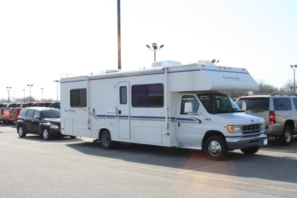

Maybe you should shoot a PM to GENELYNEMA. Here's a pic of his set up.........
