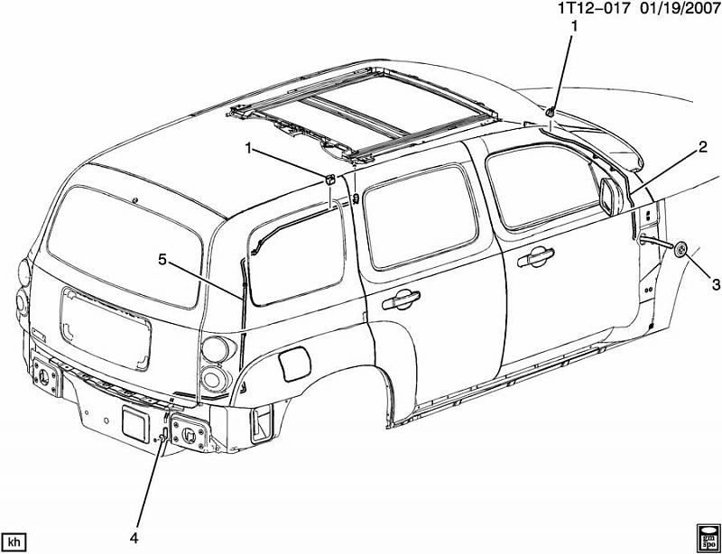

Went to change the battery and found quite a bit of water in there. Has anyone encountered this before? Just checking to see before I start ripping things apart.
Also where does the sunroof gutter train to?

Do a search. I’ve posted up the drain location pictures several times over the years.

I haven't touched it I just don't know where it is and I wanted to see if it Drained into the area where I am getting water
Old Feb 10, 2024 | 10:23 PM
Posts: 11,721
The drain tubes are inside the car until they reach the exit point. Could be leaking from the tube somewhere.
This only shows the right side drain tubes. There are similar tubes for the left side of the car. They just aren't in this picture.
Front 2 drains are at the A pillar left and right sides. Back 2 drains exit between the body and the bumper.
Other possible leak areas are the hatch weather seal. Spoiler bolt holes. Rear window washer fluid tube.
https://www.chevyhhr.net/forums/atta...1&d=1707625355

Yes thanks I did a search and found that diagram. I'll check it out today.
