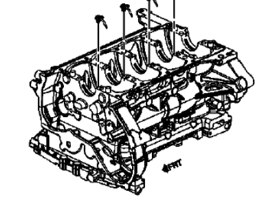

Old Jun 23, 2023 | 03:43 PM
Posts: 26,539
The pic I posted was the lower half of the case, note the bearings. If you are going to "crack" the block might as well do a full rebuild. Like an air cooled VW.
