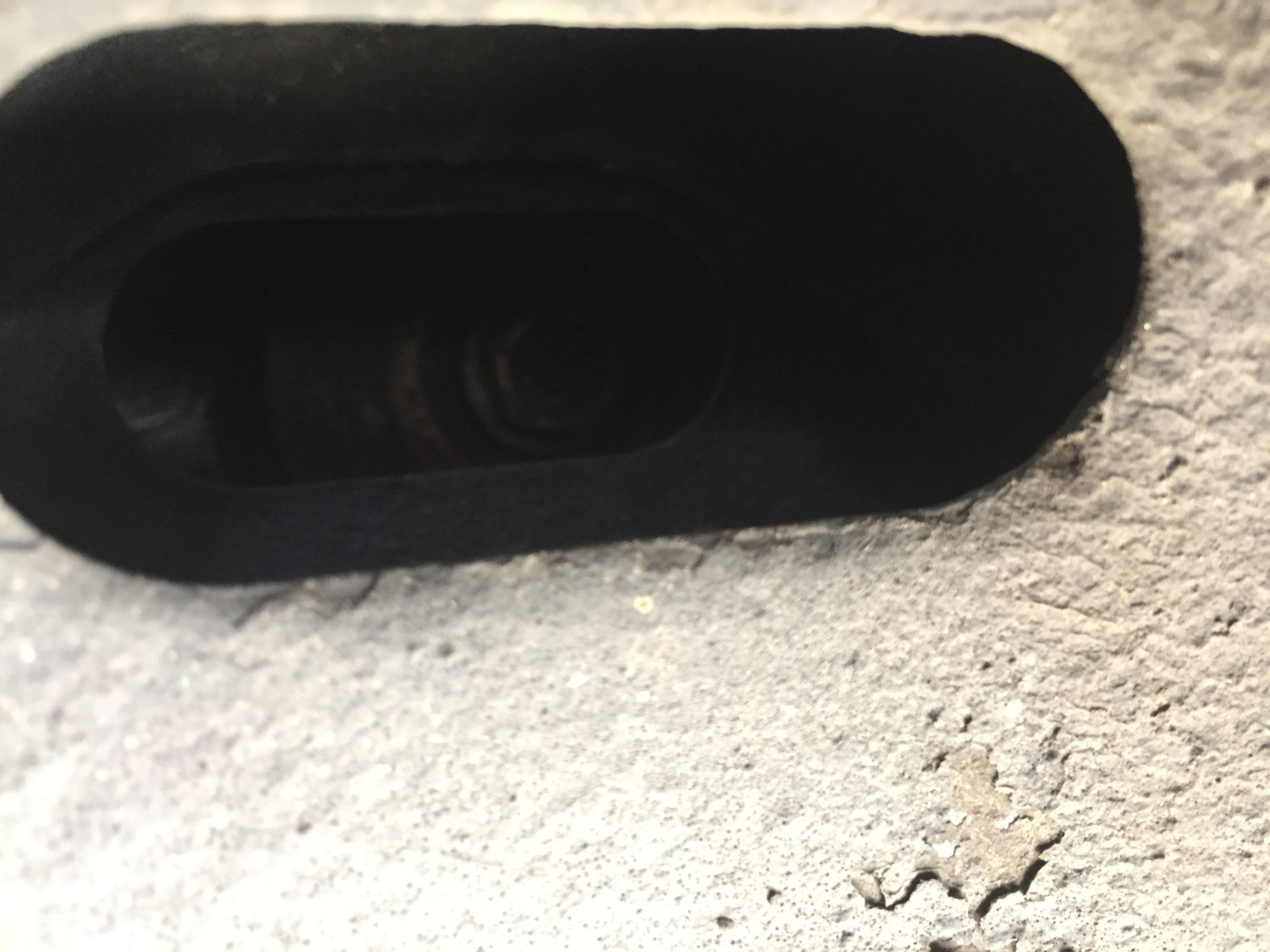

You might need to support your engine with a block of wood and a floor jack , remove the upper engine mount , check the accessory belt tension mounting bolt
Already have the accessory belt tensioner out; that access hole was convenient. Just that long bolt holding me up but will have to wait until tomorrow. I think I saw in one of the videos that the timing chain cover gasket loops around the motor mount bracket for whatever reason. So, I may have to remove the whole enchilada anyway.

I had the cover broken away from the block, but the bolt just did not want to clear the frame--too much of the bolt still in the block to wiggle out. I'll attempt to remove it again tomorrow, but probably best just to remove the motor mount to lower the engine enough to clear the frame and since the motor mount bracket need to be removed from the block to R&R the gasket. Note that the left side of the motor mount bracket and the cover where the accessory belt tensioner goes both capture the timing cover gasket.
