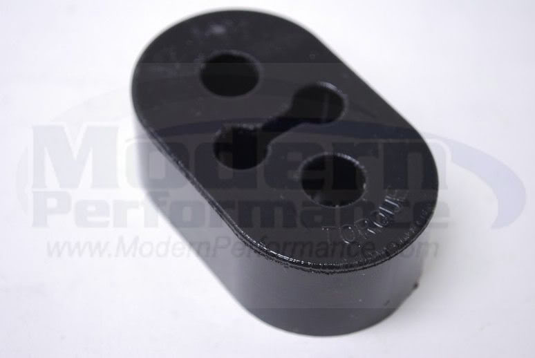

Did you ever install your kart boy bushings? I would like to know what size works. There is a new product from modernperformance also. I might pick these up. $31 for 4
http://www.modernperformance.com/tor...lt-p-2353.html

How much do u want for them? After I installed my dp I am having a clunk from the rear when I go over big bumps. I am hoping these can fix my issue. I used to have the poly hangers from kart boy on my Saabaru and his shift knob.

I thank you for offering to sell me your extra kart boy hangars but I fixed my exhaust. Seems I did not reinstall the hangars properly or 2 of them worked their way off the Exhaust. Either way it's back together now. I will let you know if I have problems in the future.
