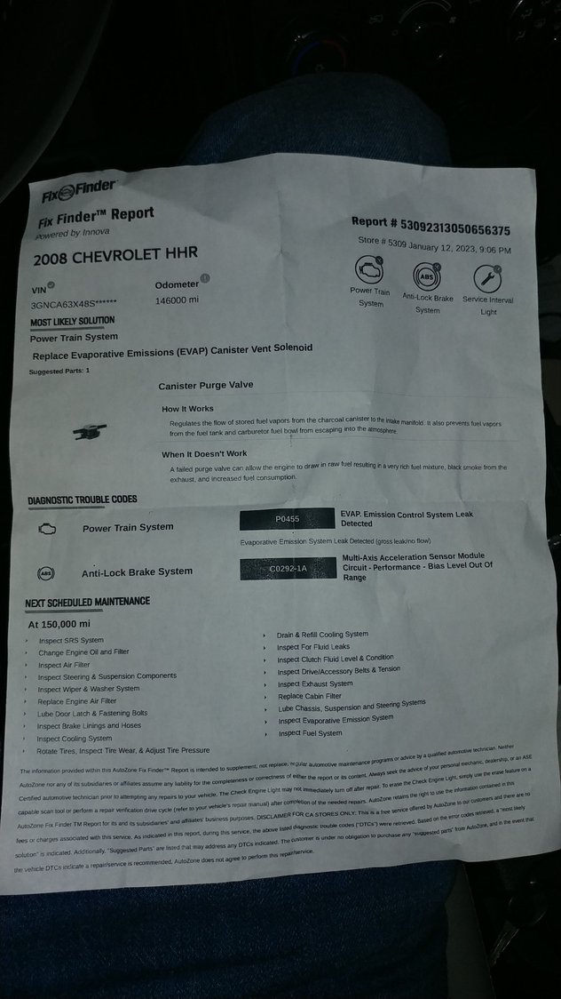

Sorry, here is the paper they gave me.
I notice it blows a decent cloud if dark grey smoke when I let off the gas sometimes. Put 2 half tanks of arco 91 in it so far so I don't think it would be the fuel at this point, unless the fuel filter is dirty with it??
it's running really good other than a low idle that dims the lights and acts like its going to stall out, which is fixed by giving it some gas. Could this be injector related? Its odd that it only happens after I've been driving a while.

the smoke problem could be valve guides, valve guide seals, piston rings , EVAP purge valve.
install the new one and test drive it again.
