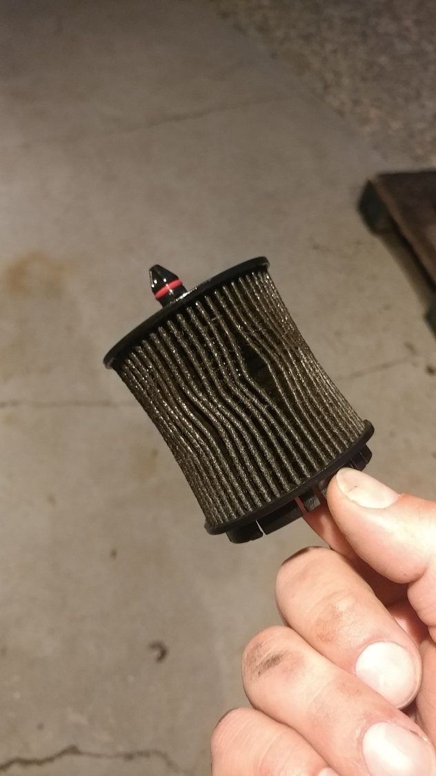

Just swapped the plugs. Checked the oil filter. Is this normal for 50 miles? I'm gonna guess that the sludge has mixed with the new oil. I didn't drive it very hard. 3k rpm. Got up to 207°F.

Precisely the reason I suggested change the oil and filter.
