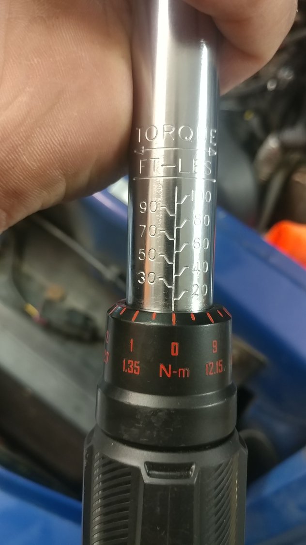

Ft lbs or inch lbs for the thermostat housing?? We have a craftsman that goes down to 20 or theoretically 10...
Old Jan 1, 2023 | 07:37 PM
  #170
RJ_RS_SS_350's Avatar
Joined: 05-01-2014
Posts: 8,512
From: California
Inch pounds. Typically torque wrenches aren't very accurate at their lower limits like that. You can get an inch lb torque wrench for under $20 at Harbor freight.
