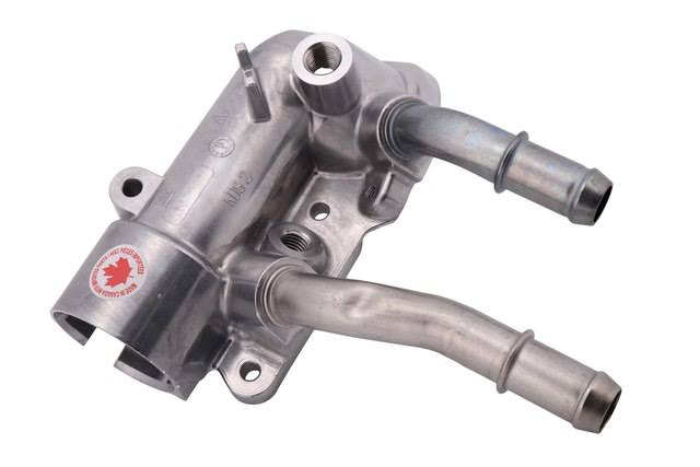

Are the heater hose pipes out the top?
Like this ?

This is a photo of an LNF 2.00 litre thermostat housing.

The SS part #12605853
2.2/2.4 part #12597172
Not very different. But a little bit. The hoses come closer together on the 2.2/2.4, perhaps allowing more room to get around behind them with your hand.

The banjo bolt? I've already got that off. I took one hose off...took me 10 minutes....ugh. But the 10mm bolt closest to the passenger side is blocked by the rusty thing connected to the turbo. I could *maybe* get to it with a swivel of some sort but it would be a PITA to put back on. I'm just gonna try to remove that thing connect to the turbo to make it easy on myself lol. Unless someone has a better way.
