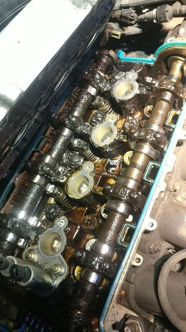

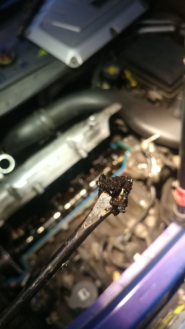

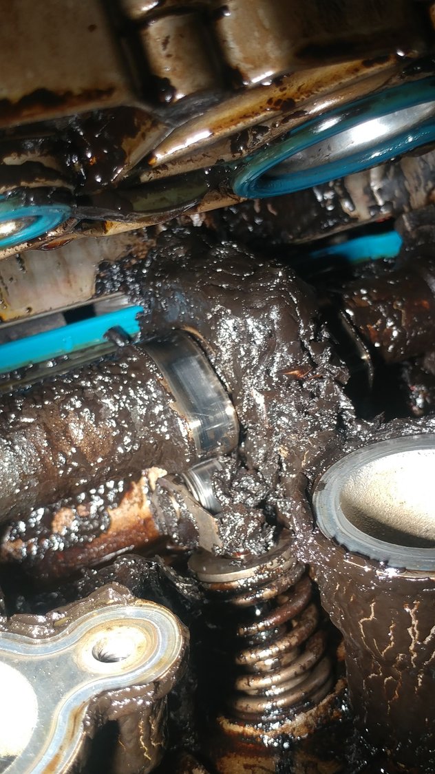

Opened up the valve covers today....timing chain loose...lots of gunk in here. Did they never change the oil or what?

Yeah. That engine did not see regular oil changes.

Cam lobes look cooked, I’d be inclined to remove the head and clean everything up , replace the head gasket and the timing and the balance shaft chains, the water pump, and the oil pump.
It’s not a hard job, time consuming but it’s worth the effort.

That's not deferred oil changes, that's oil emulsion, probably combining with coolant.
I tend to agree. The cylinder leak down test I mentioned in his other thread might prove it, if it's the head gasket. But it could be leaking at the oil cooler, or internal leak in the turbo, test probably won't show that.

Like I said, change the head gasket, and the water pump and the chains. When you drain the radiator, look for oil in the coolant. If it’s contaminated, change the oil cooler and radiator, and hoses, once you clean it up!
in or out of the car not a bad job!
This is for a 2.4 but the 2.0 is similar
http://www.ddmworks.com/assets/image...uild%20Kit.pdf
If you remove the upper engine mount and the bracket for it that gives you more room to get to the front cover bolts. I’d even consider a new oil pan.

Need another engine. I wouldn't waste my time on that one. Fix one thing and something else will fail.
That much crude in there will plug up oil passages and galley's. Next will be oil pump then rod and main bearing failure. And I'll bet the turbo is on it's last leg if not shot.
