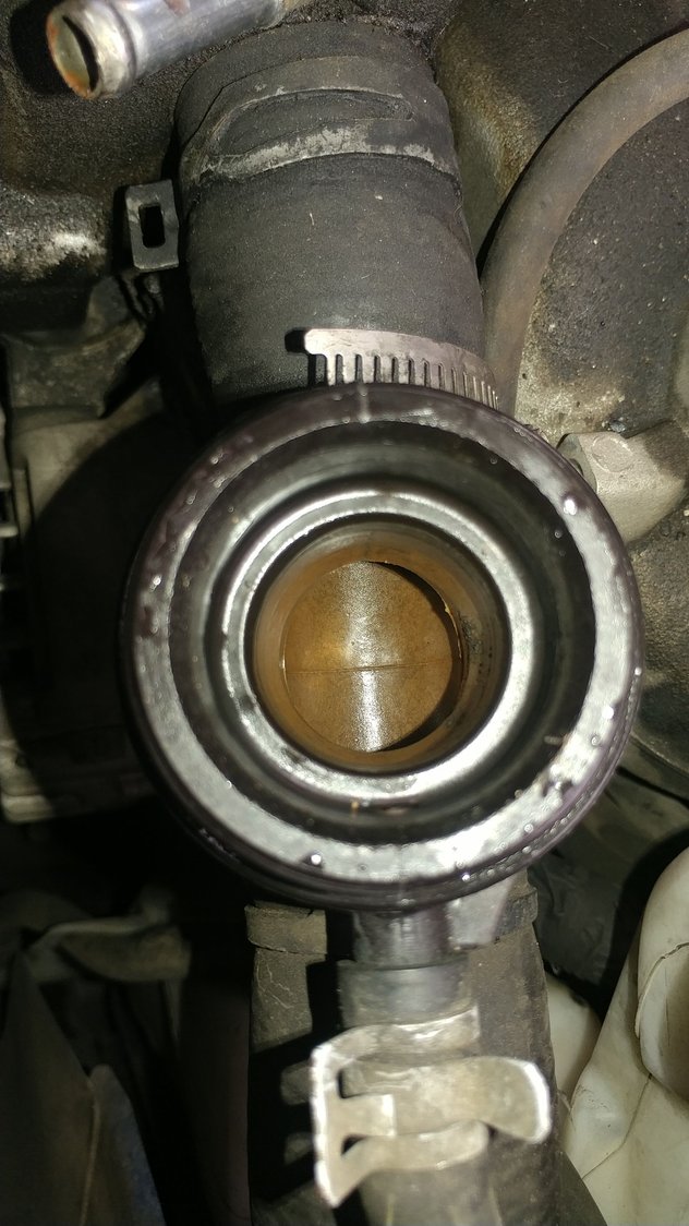

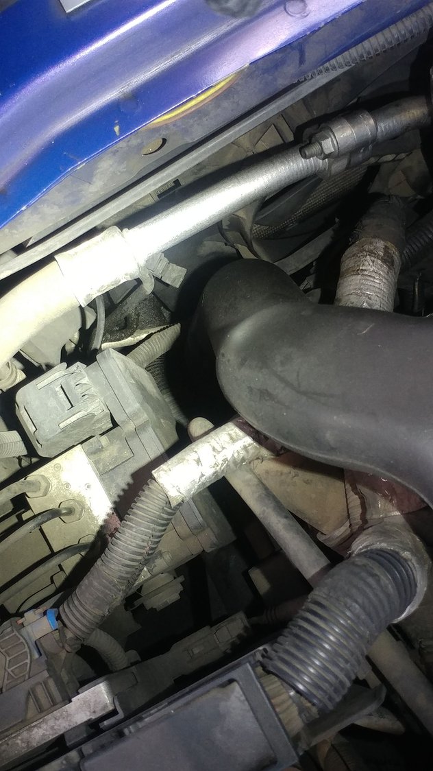

Looks like transmission cooler lines are leaking at the radiator. I’ve cleaned up way worse, it’s a gamble, put time and some parts into it. If it ran good, it’s probably just a head gasket. Can you please post a photo of the filler neck with the rad cap off? Straight down into the opening, please
Old Dec 11, 2022 | 04:41 PM
  #55
hhrumadbruh's Avatar
Joined: 03-17-2012
Posts: 1,042
From: Bay Area, CA
This thing?

You have to cut it off. Or you can remove it from the turbocharger, then remove the valve cover with the hose still attached to it.
Pretty low on coolant.
Old Dec 11, 2022 | 05:37 PM
  #57
Posts: 40,083
Very low on coolant.

From: Bay Area, CA
Yeah its basically poring out behind the motor somewhere. Maybe the water pump.

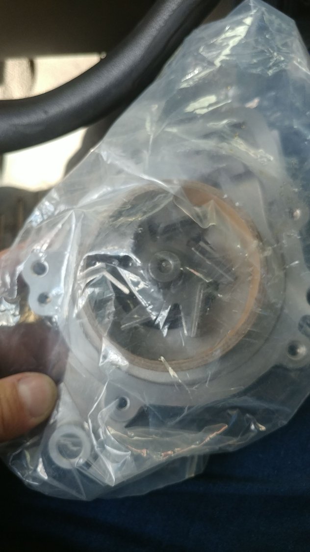

Can anyone tell me if I just re-use the outer case that connects to the 2" metal tube on the water pump?
I believe that is the case here. If so, do I install new gaskets/o-rings for it?
Old Dec 12, 2022 | 04:23 PM
  #60
Posts: 40,083
https://www.chevyhhr.net/forums/how-...acement-56476/
Always replace the orings and the square gasket on the thermostat housing
