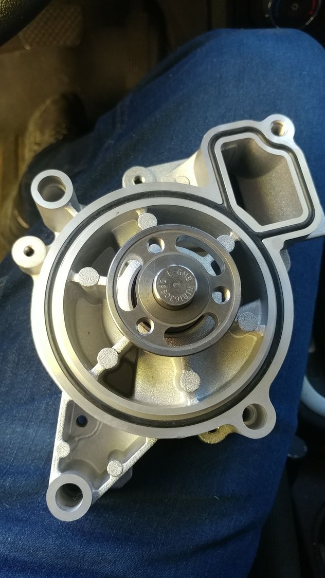

Dang...ok I guess I'll order that stuff. Any links to a complete kit you would suggest?
Water pump stuff too. I don't like how the "duralast" from AutoZone for $80 is Chinese. I think I'll take it back

The pump in the picture is a good one, metal impeller. Some others have a plastic impeller. Don't discard Chinese just because, kindof racist. Cheap American is crap.

Ok I'll keep it. Am I just going to use the existing cover and gaskets that go on the propeller side?
