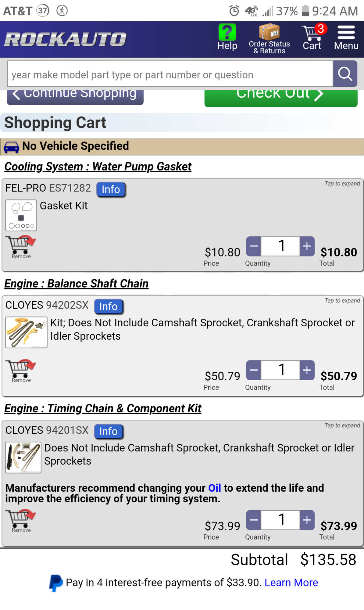

any suggestions on timing chain kits? Going to do water pump and timing chain. Any other stuff I should get?
is there a kit for water pump gaskets? I assume I re use the outer cover

Timing chain kit 9-4201SX doesn’t include sprockets, good, cause the 2.0 uses a different sprocket on the crankshaft, so reuse yours
Balance shaft kit 9-4202SX also no sprockets .
and yes there’s a kit for the water pump

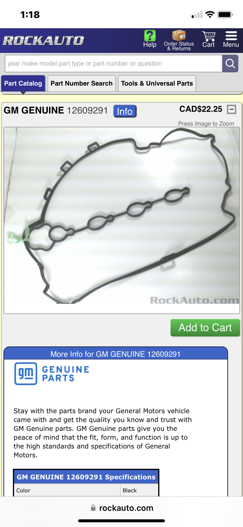

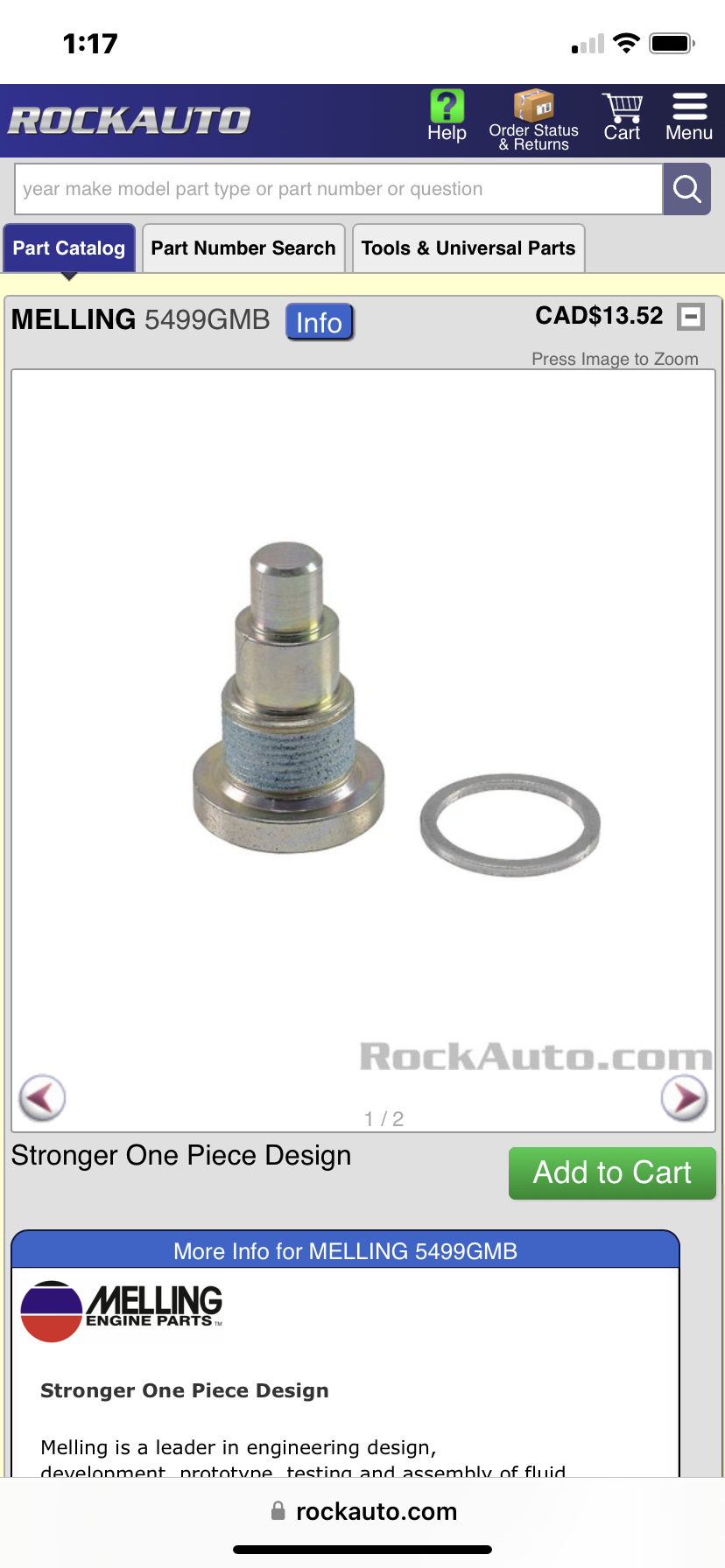

Front guide replacement bolt. A must have!
Valve cover gasket set at your cars age give it a new one!
Same with the front cover, I replaced a 3 month old FelPro gasket with this one.
