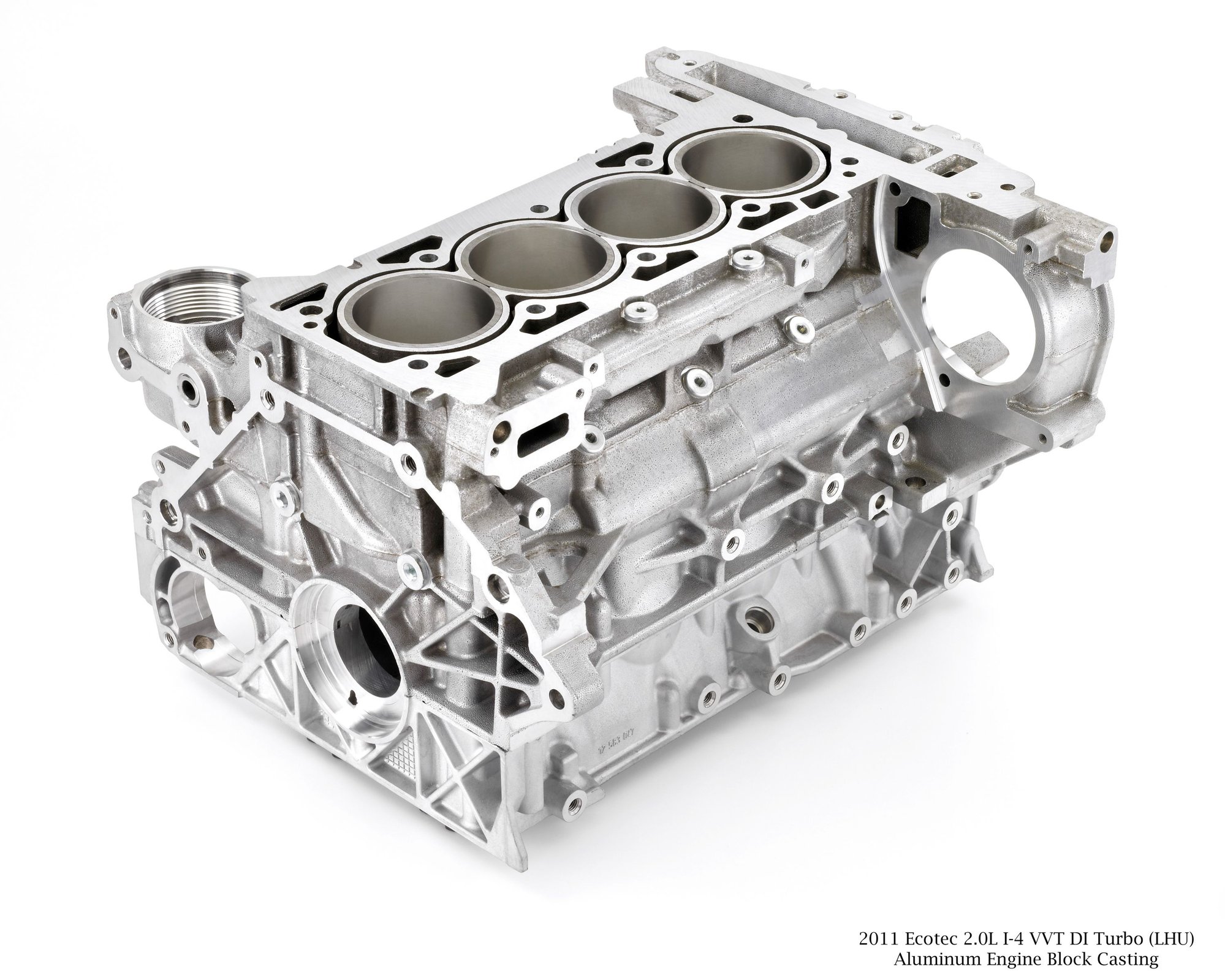

From the top of the block see the water jackets, over on the left by the water pump. Possible leak area

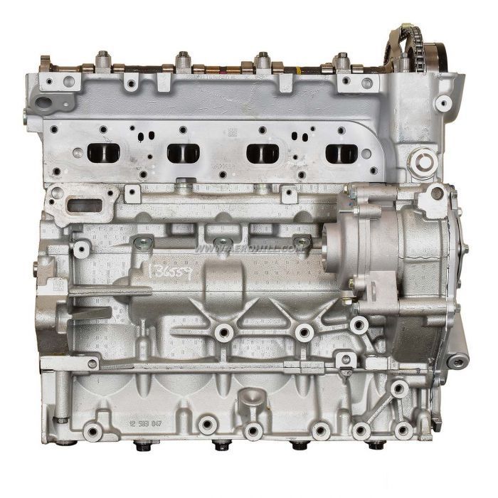

Here’s a look from the water pump mount side , it could be the gasket just above the round hole where the water pump bolts up!
With the water pump bolted on no you can’t see much , however the cylinder head does sit just above the water pump, you should be able to see better once the pump is removed

Thanks for the pics. No wonder I can't find the source. Its hidden back there. Hoping its the water pump or gasket!
I should be able to tell after I've replaced the pump and gaskets.
