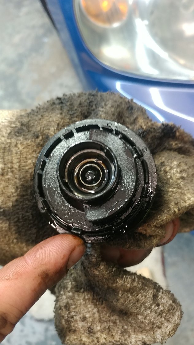

did some cleaning on the valve stuff today. I noticed its not actually hard but more of a tar-like material that quickly turns into mush when I squeeze it. Pulled the oil filter off too.

Can you say, neglected oil and filter changes?
