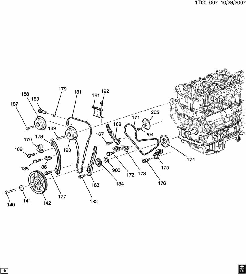

#900 shows the shim behind the sprocket, like Oldblue said

Photo of LNF 2.0 timing chain sprocket, now shims
Same engine

They're so thin, it doesn't seem like it would make a difference, but...
The slight misalignment of the crankshaft gear could potentially cause premature wear, the smart move would be to put them where they belong.

Im sorry but i can't see those pics or they don't enlarge for me to see anything in detail.
is the right place in front or behind the timing sprocket?

FireManGeorge gave a link in the other thread. 1 in front and 1 behind.
