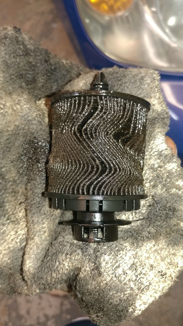

Got some oil and a filter.

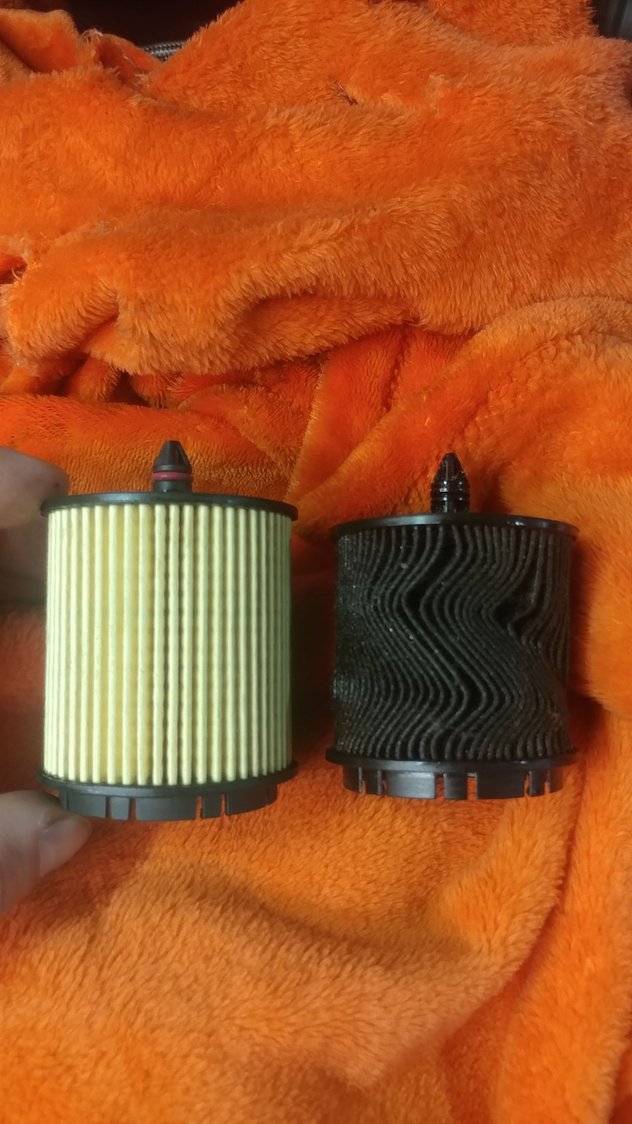

anyone know why the existing oil filter had this extea clip and a spring? Does the 2.0 just use the same filter as the 2.2 and 2.4?

From: California
All years and Trim levels use the same filter. That might be the wrong filter, might explain why it's so badly crushed, are there any numbers on it?

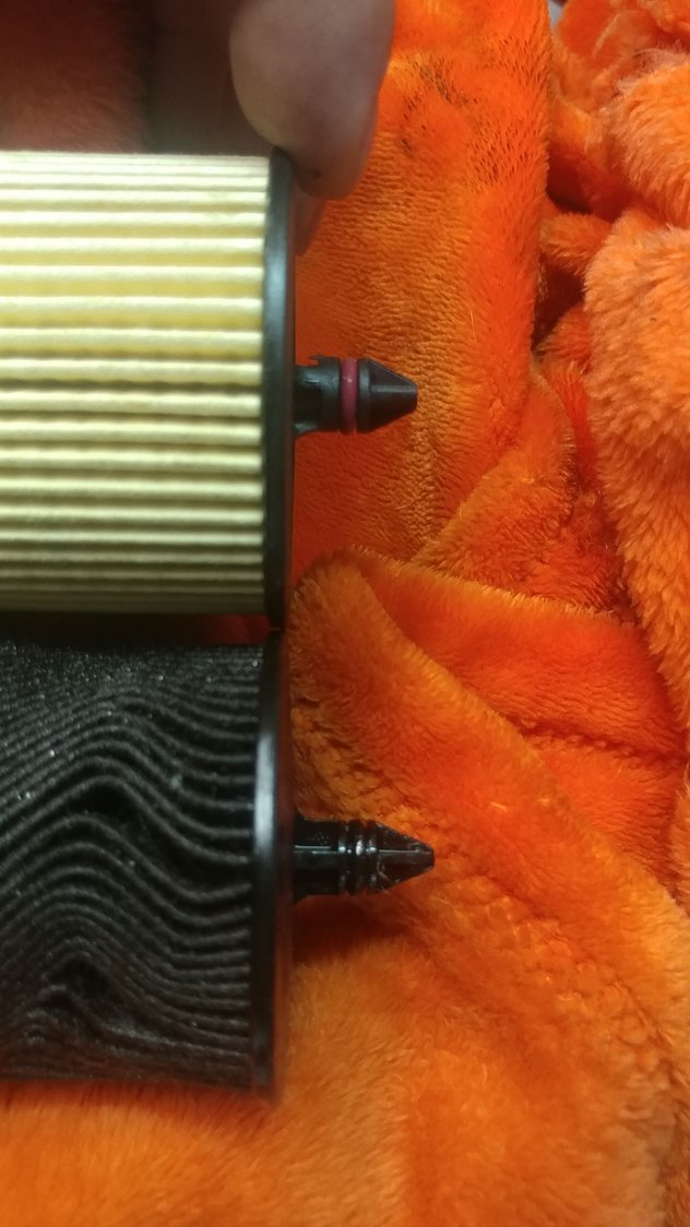

From: Bay Area, CA
I think I tossed it already. :/
looks like the same filter but with an extra piece on the bottom.

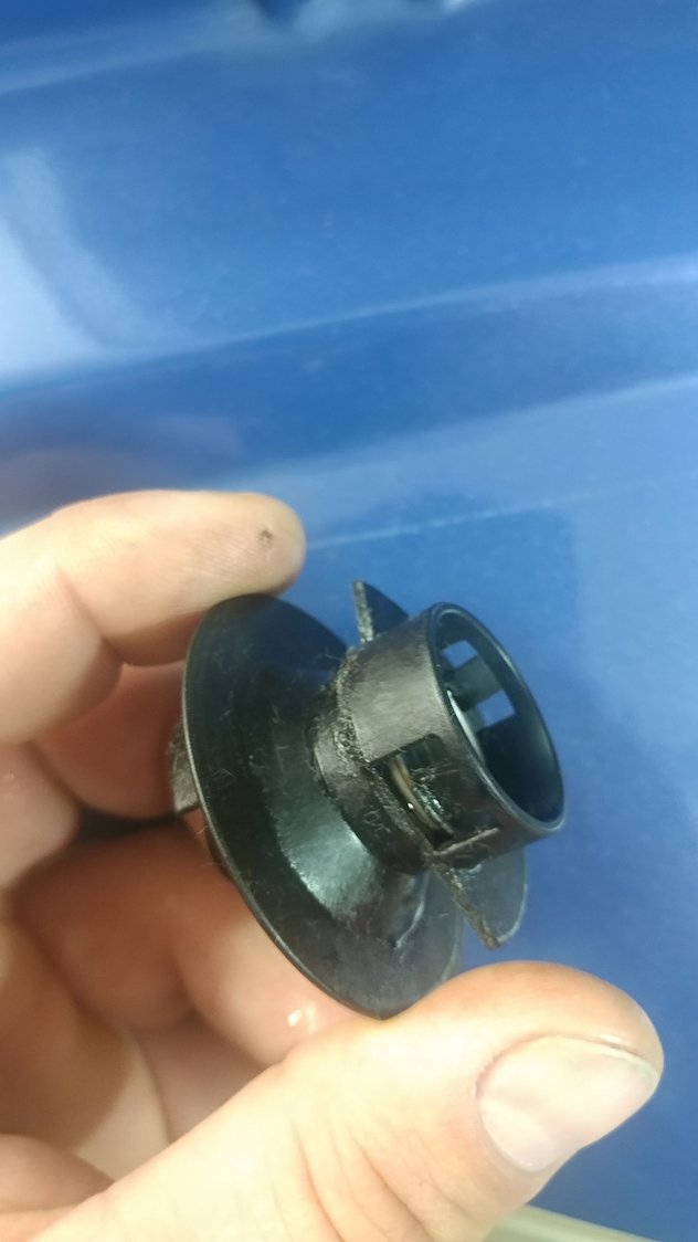

From: Bay Area, CA

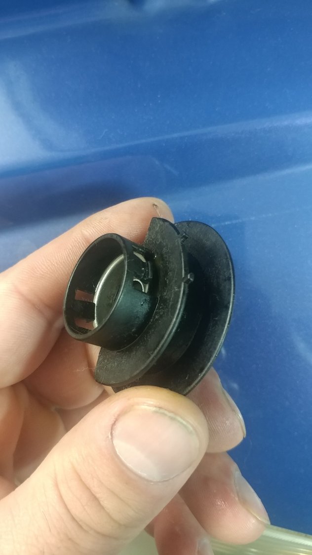

Dug it out. Im assuming this is a stock oil filter cap and it just broke?

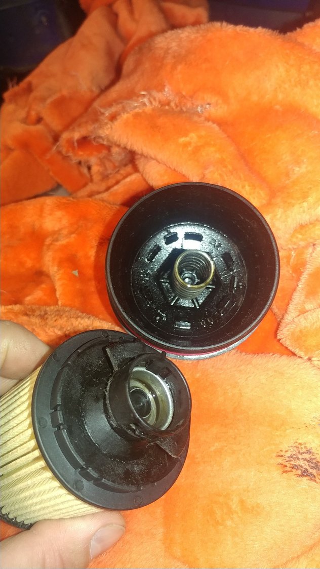

Posts: 40,087
That is the oil filter cap end of the oil filter, the end with little point goes downwards into the oil filter housing
Left photo is the top, pointed end is bottom , it appears the cap could be damaged somehow

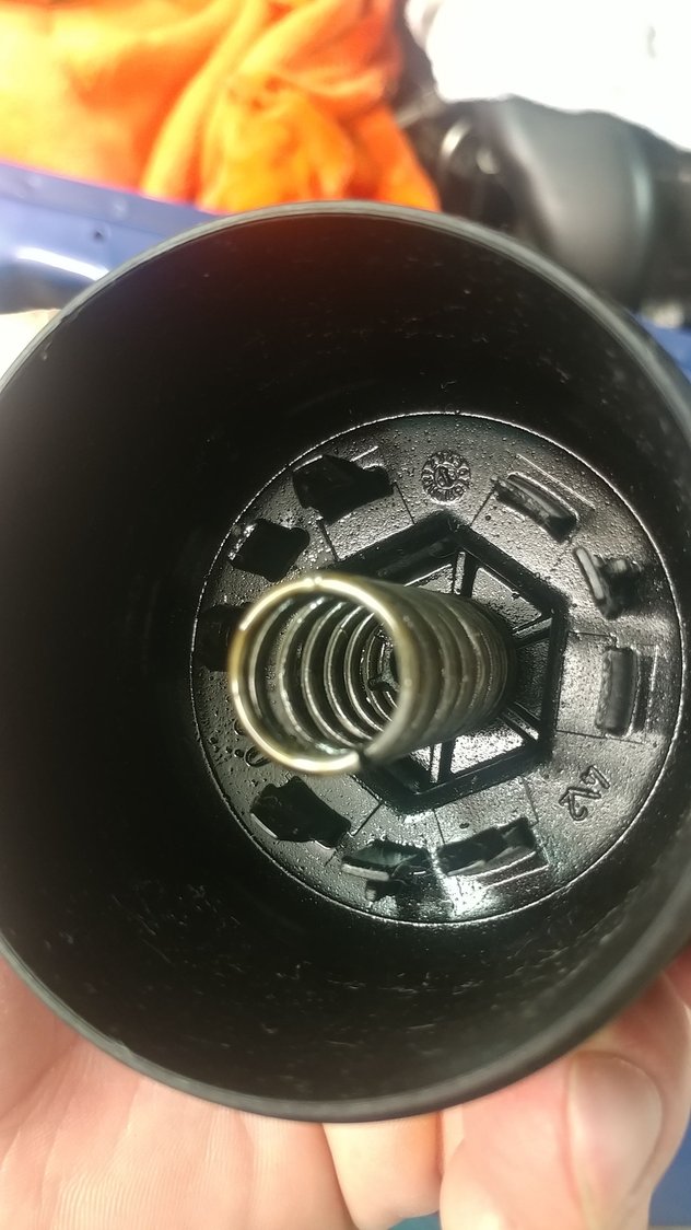

From: Bay Area, CA
Ok I'm pretty sure this piece is just broken. It seems to work just fine when I put it together.

From: Bay Area, CA
Also...with the insert being broken, it would not stay in the actual oil filter cap and cause the filter to compress the way it did. Which makes sense now.

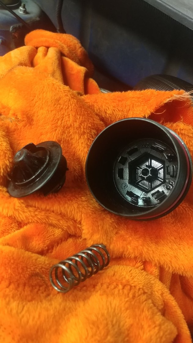

From: California
I think the broken part is part of the cap, not the filter.

From: Bay Area, CA
Yes 100%. The little spring tensioned insert up top.

Posts: 40,087
A new cap with seal and oil filter isn’t that much to order, or pick one up at your local parts palace!
