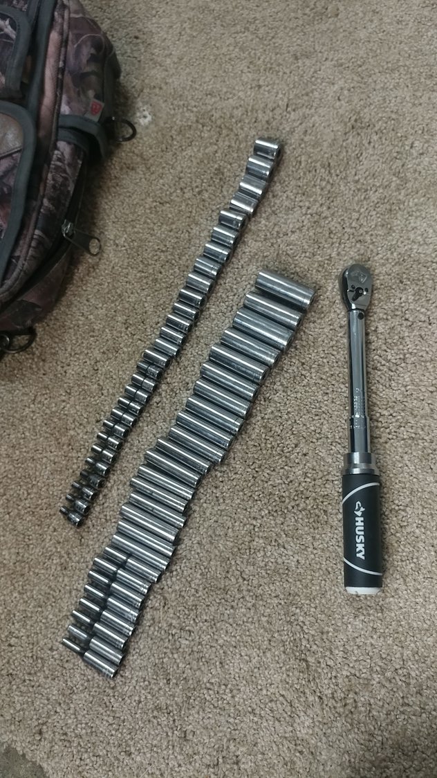

Got it. I wont.
Any suggestions on a decent digital inch lbs torque wrench? Don't see anything in stock locally so I'll just have to order it. Heading to home depot and Lowe's now just to double check. Ace and harbor freight just closed.

Good thing I have a ton of 1/4 sockets already!

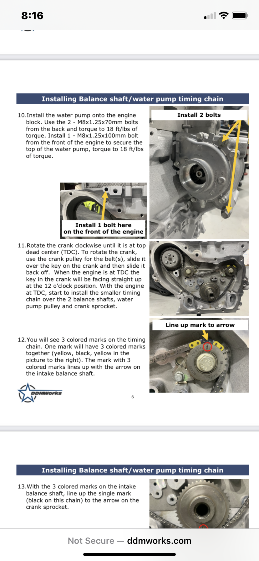

anyone know which bolts go where?

The long one from the front above the front cover, the 2 shorter bolts in from the transmission side on the back of the water pump. Save the last for after you install the front cover.
Here’s the dimensions of those bolts

I did post that DDM tutorial about VVT Ecotec assembly, loads of information in that.
