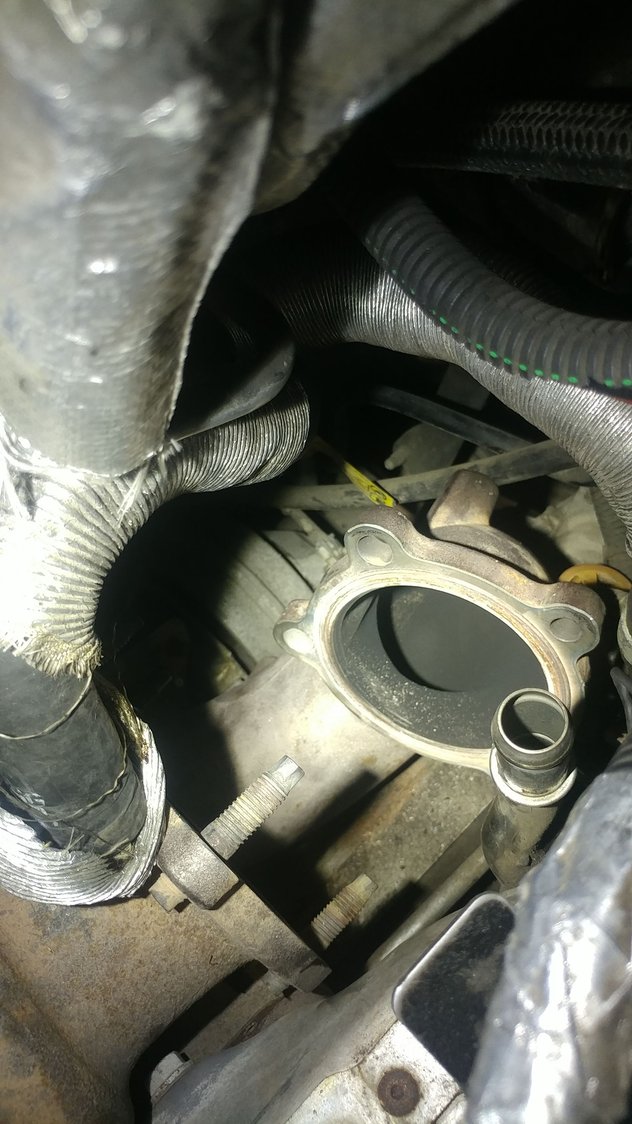

I managed to get to the 10mm bolts on the thermostat housing. Had to remove the right side pipe. I can see why people hate working on these cars and why labor costs are so extreme. I wouldn't do this for anything else for less than $500 lol

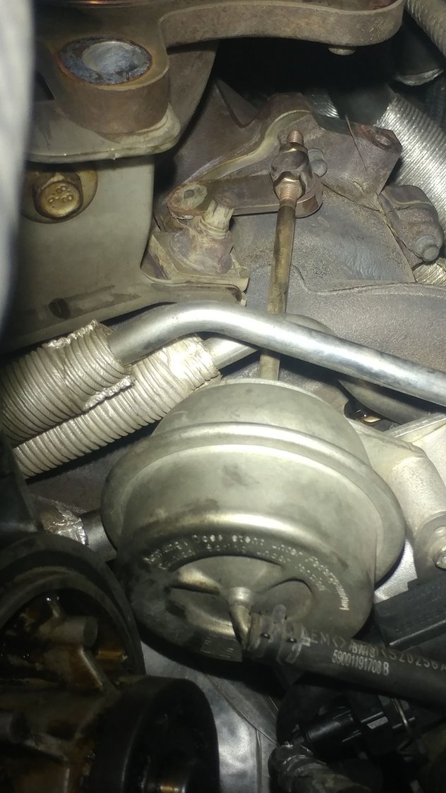

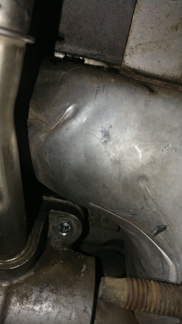

Ok I've narrowed it down to this thing. Anyone know what this is? Does it need to be adjusted if I remove it?

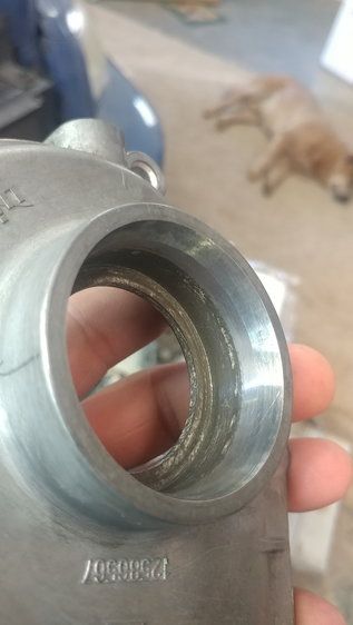

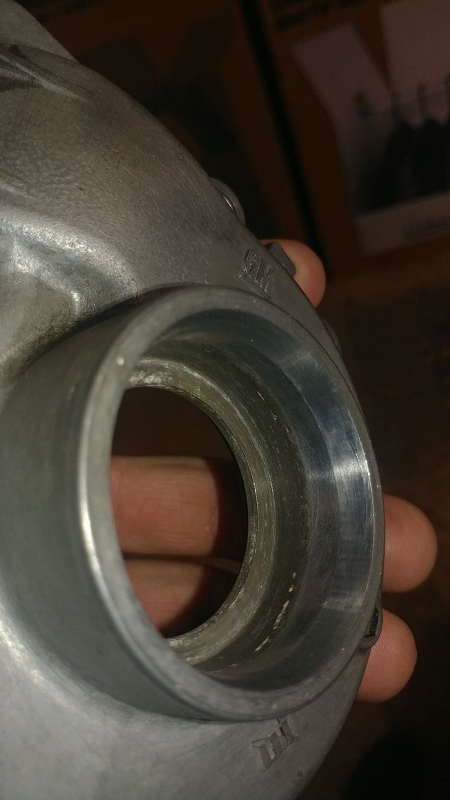

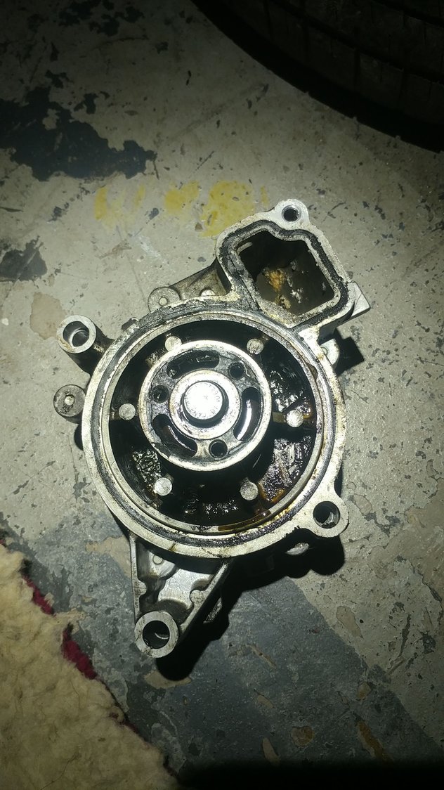

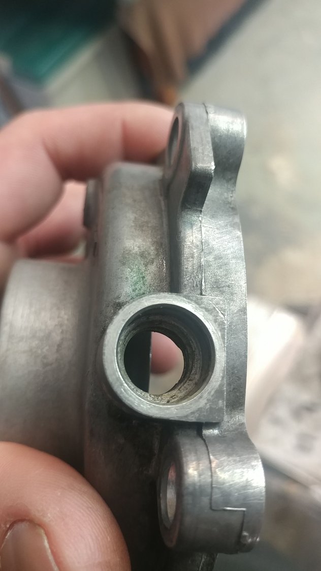

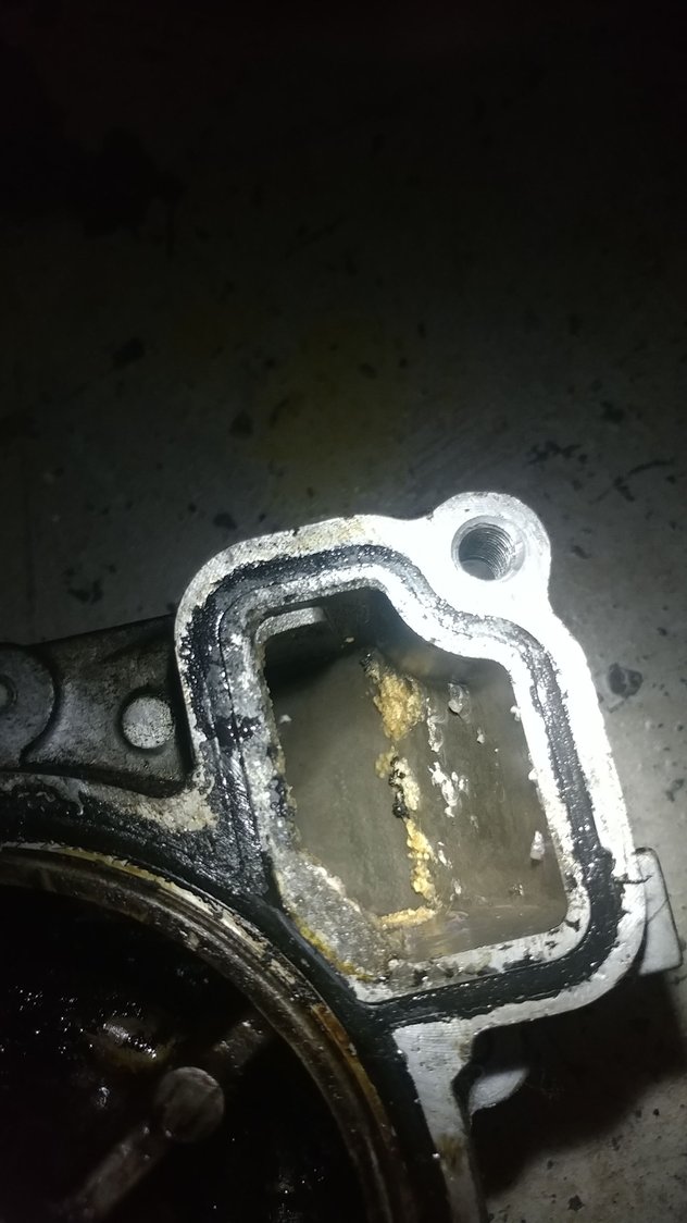

Not sure how but I've managed to wiggle it out.
Not fun but it was rewarding.
Here are some pics.
Old Dec 31, 2022 | 07:23 AM
  #154
Posts: 40,083
A crusty looking water pump! Now clean the mounting surfaces and put new orings in place and install the new water pump,

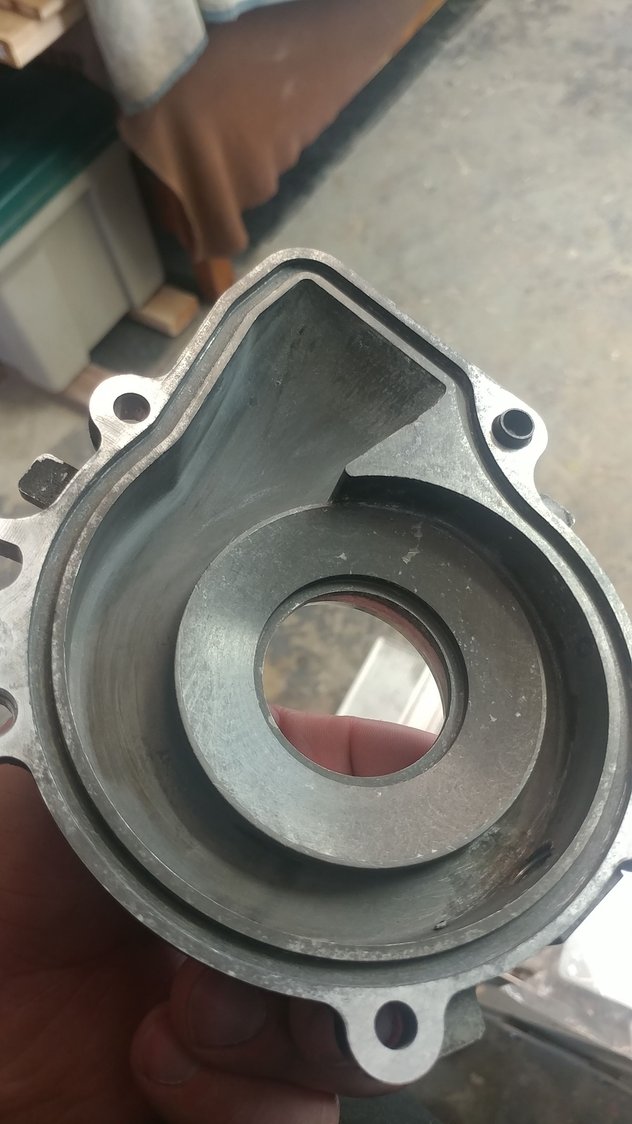

Can I re-use the outer cover? All that orange stuff scraped off.
Old Dec 31, 2022 | 10:08 AM
  #156
Posts: 26,533
Looks like the pump was previously replaced by someone that doesn't trust rubber O-rings for sealers. The previous owner did not believe in changing oil or using the proper synthetic oil. Synthetic oil leaves a brown/orange color on the metal not black.
What "outer cover"? If it is metal and not bent reuse it.
Old Dec 31, 2022 | 10:18 AM
  #157
hhrumadbruh's Avatar
Joined: 03-17-2012
Posts: 1,042
From: Bay Area, CA
I don't know the proper name. Its the half shell that faces the driver side that holds the 2" silver pipe. It has 4 or 5 10mm bolts that holds it into the actual water pump. And it has the drain bolt on it.
Old Dec 31, 2022 | 10:35 AM
  #158
Posts: 40,083
Yes you can reuse that, clean it well and use a new gasket
