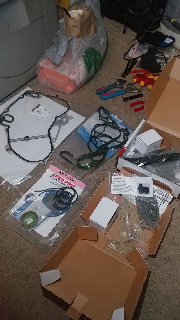

All the parts came in yesterday!
Going to start on it today.

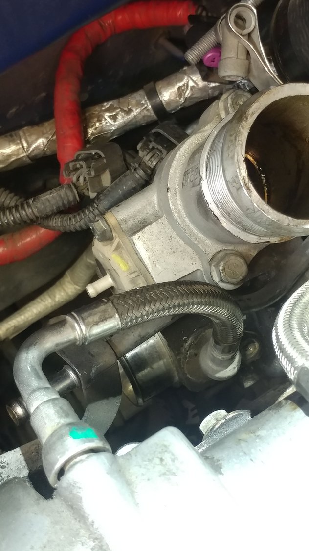

Anyone know how to get this thing off so I can remove the valve cover? Already got the bolt out but its not coming off.
Old Dec 22, 2022 | 07:25 PM
  #103
RJ_RS_SS_350's Avatar
Joined: 05-01-2014
Posts: 8,512
From: California
If I remember, it just comes straight out, there's an O-ring around a tube.

Got it. Just had to pull a bit. It was a pretty tight fit.

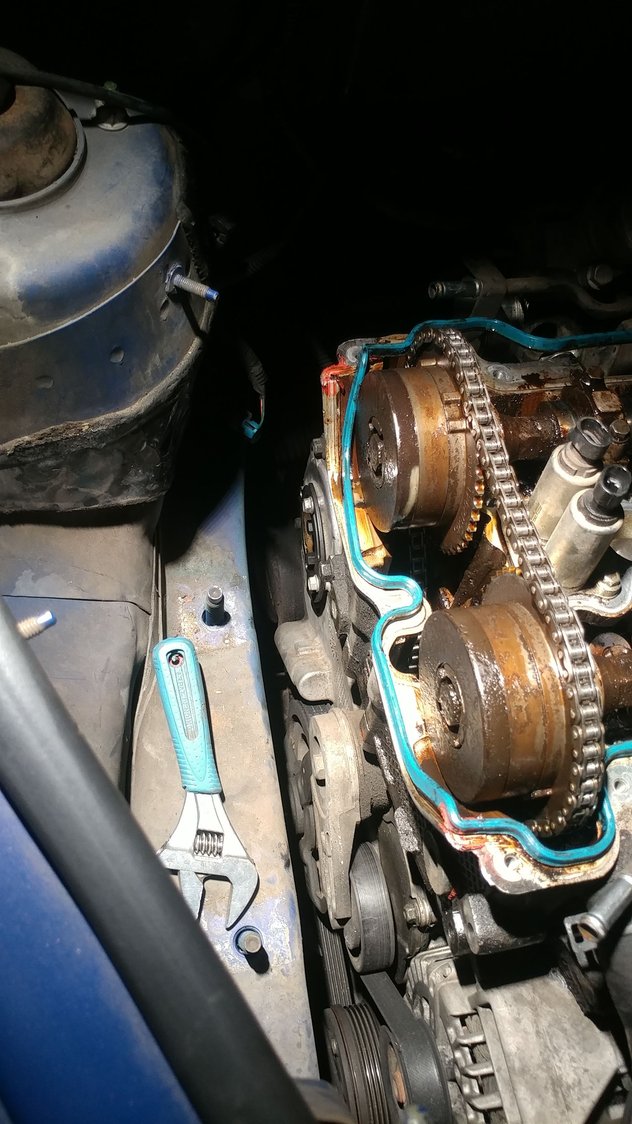

Took the valve cover off, did some cleaning.
Propped up the motor via block under the oil pan and removed the passenger side motor mount. Got it up a decent amount.
What do I need to take off next?
Old Dec 23, 2022 | 07:17 AM
  #105
Posts: 40,083
The harmonic balancer bolt, then the serpentine belt and tensioner, then the front cover.
That will get you access to the chains. You will have to lower the engine to get the long water pump bolt out!

Forgot to order new camshaft sprocket bolts. I wonder if napa or AutoZone would have them?

Orielly said I could have new camshaft bolts by 3pm so I'm gonna do that.

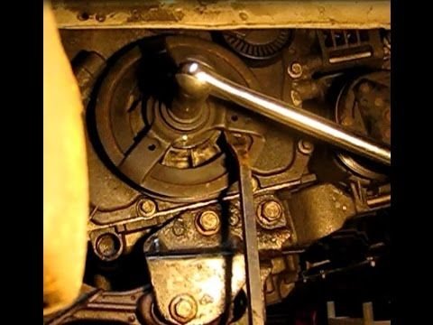

Old Dec 23, 2022 | 02:25 PM
  #110
Posts: 40,083
This one it’s a 21 mm use a pry bar or large screw driver to hold the harmonic balancer to loosen that bolt.
