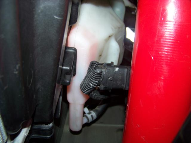

When I added IC pipes, I could not see anyway of getting anymore clearance to the T-map, at its present orientation, even if I moved the IC foward a bit, which I did. When I pulled the Stock pipe out I could see where contact was made between the AC and the T-map. Also, when I first had the GMTU installed, the tech was scratching his head while telling me, that "that extra lower sensor, if awefull close to the AC.
Before I installed the pipes, I would get an occasional "hit" and "mis". So after F'in with it for a while, I flipped the T-map around and bumped the radiator foward about an inch-and-a-half. No more problems and plenty of clearance, at least for me.

Anyway you fix it, get it away from the downward tourque. I wonder if the Motor Mounts will stop this?

Stiffer mounts should help. But the engine lifts up in the front pulling the t map up and back not down.
GMPD said you could flip the T map but you had to watch the clearance on the front. Not all cars will be able to do this.
