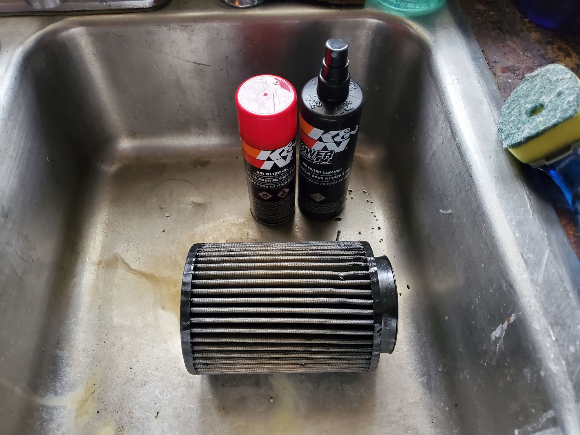

So someone above asked about new air filter. Now that I know this car is worth while and worth putting money into I have purchased the cleaner kit.
and man was this thing dirty.
I need a lid and screws for the stock air box. Dose anyone have one they can sell for cheap with the screws? I'm located in michigan.

So Dark Knight the "steering angle sensor" is the clock spring ?
Also just put an AC delco filter in and forget that K&N garbage,
Do a research on air cleaner air flow and you'll know what I,m talking about.
K&N is all hype and nothing more.

Iv been in the performance automotive world for 25 years brother. The K&N issue with filter chargers are do to people over drenching the filter with oil and also due to people putting them right on after applying the oil to heavy. Other than that yeah they dont offer much more flow or filtering I agree there. It's just what I have and the cleaner kit was cheaper being napa had it on sale for $8.
