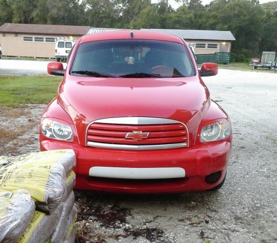

What's with the red paint on the top of the lense ?
Old Feb 21, 2020 | 07:09 AM
  #112
Posts: 40,083
Kinda an eyebrow, note how the inside of the headlights are also painted red.
Search Headlight Eyelids.
To each their own.
not sure that's how I got the car. It looks to be done by spray can and has shrunk and cracked. Not my style. But once i can I'll buy new headlight assemblies.

Thanks Dark Knight, as it's not my style also.
Looks like something somebody did in a dark alley.
