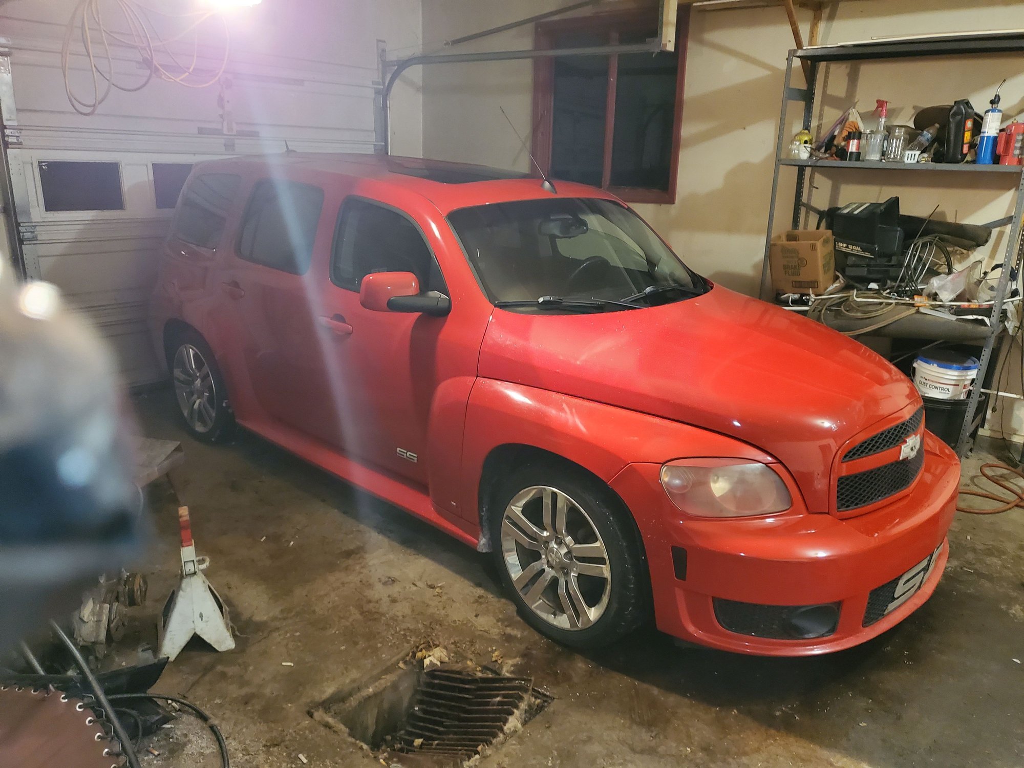

Guys guys hey guys lol
It's done. It runs pretty good. Needs some calibrations done and a wheel bearing but man it's so nice to drive a car that dont bang tick and click with every movement. I'll get a video of it running tomorrow. Still gotta burp the cooling system. But man I'm so greatfull.
