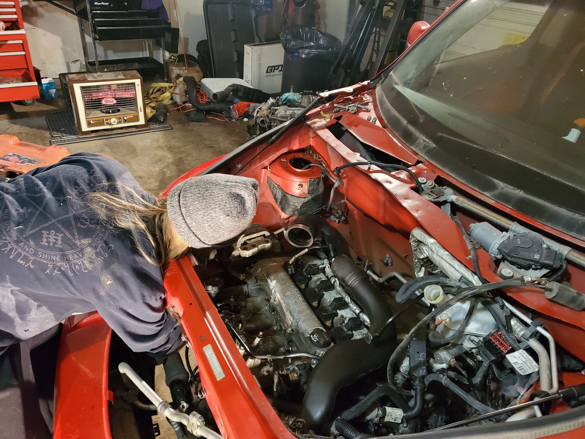

Might have a problem
So last night one of the guys swapped the flywheel in place of the flexplate. (New motor was from a manual car my car is a auto).
anyways one of the guys used the long bolts for the manual flywheel to install the flexplate. Needless to say it it stopped the engine from rotating. Only thing that worries me is he said he heard a pop when tightening the bolt.
After swapping to short ones all seems fine. But worried what that pop was he exsplained. Worried something somewhere broke. So today I'll be going out and measuring the depth of the hole for the flywheel bolt and comparing to the length of the long bolts for the flywheel do gain some direct. Hoping this didnt crack the main web or something along those lines by pressing against it to hard.

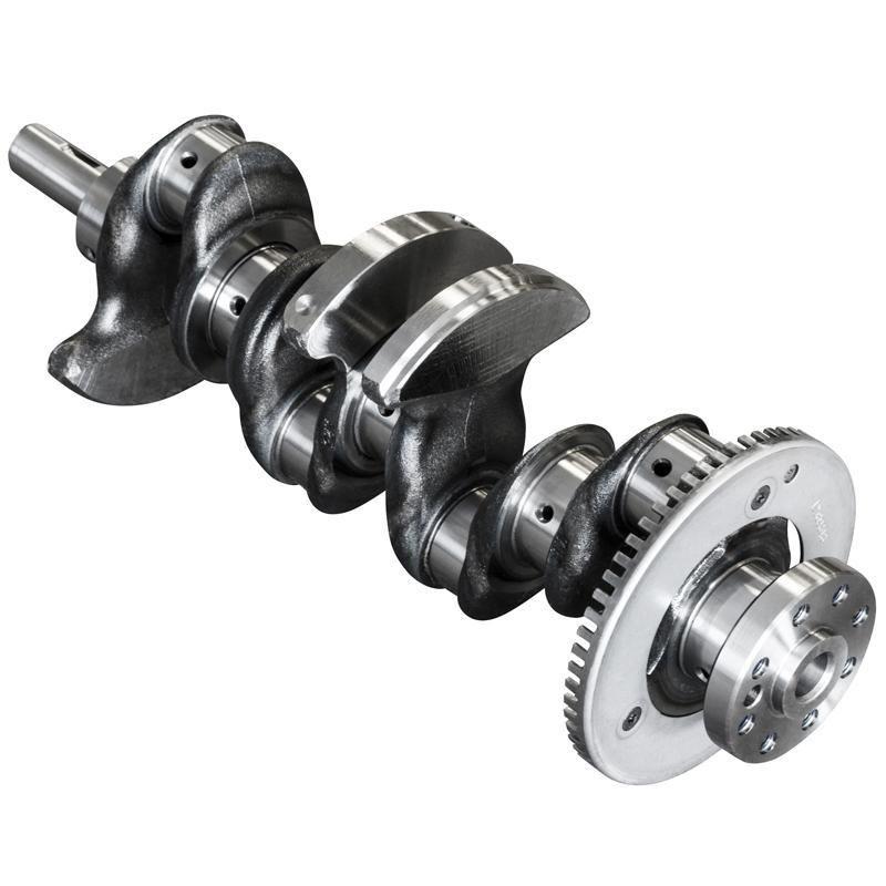

Here’s a picture of that end of the crankshaft, looks like this long bolts could have damaged the rear main bearing cap, not the web

Motors going in.
found a video that showed about 1/4 distance between the crank and the main. So I'm hoping the pop was just the flexplate seating. But in it gos. Snake cam showed nothing.
