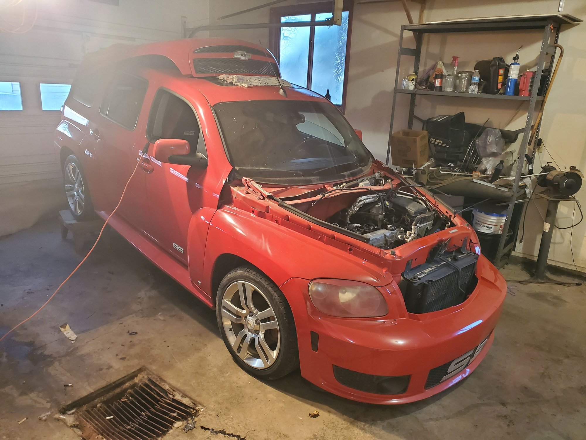

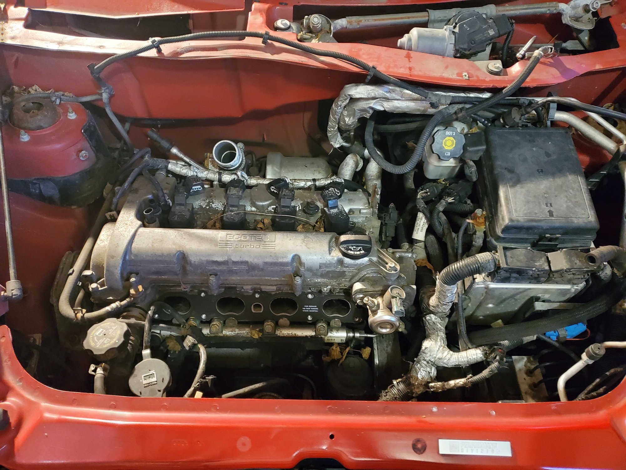

And so it begins. Iv had a kind guy volunteer to help me with all the lifting and laying on my back.
I used a camera and looked at the valves on the new engine and there not bad. I will run a treatment threw it using the vacuum ports and finish them off.
we are currently without a car and this one is badly needed.
Anyone have any vacuum routing diagrams. The guy that tore this car apart didnt leave much for assembly. And me not being the guy that tore it down I'm in the dark.
I would love more info on the pcv issues and how to fix them. I'm familiar with catch cans ect... as I used to own a auto repair and performance shop for a number of years. But I'm sure you guys carry more hhr ss specific info that alldata and gm dont carry. Thankyou.

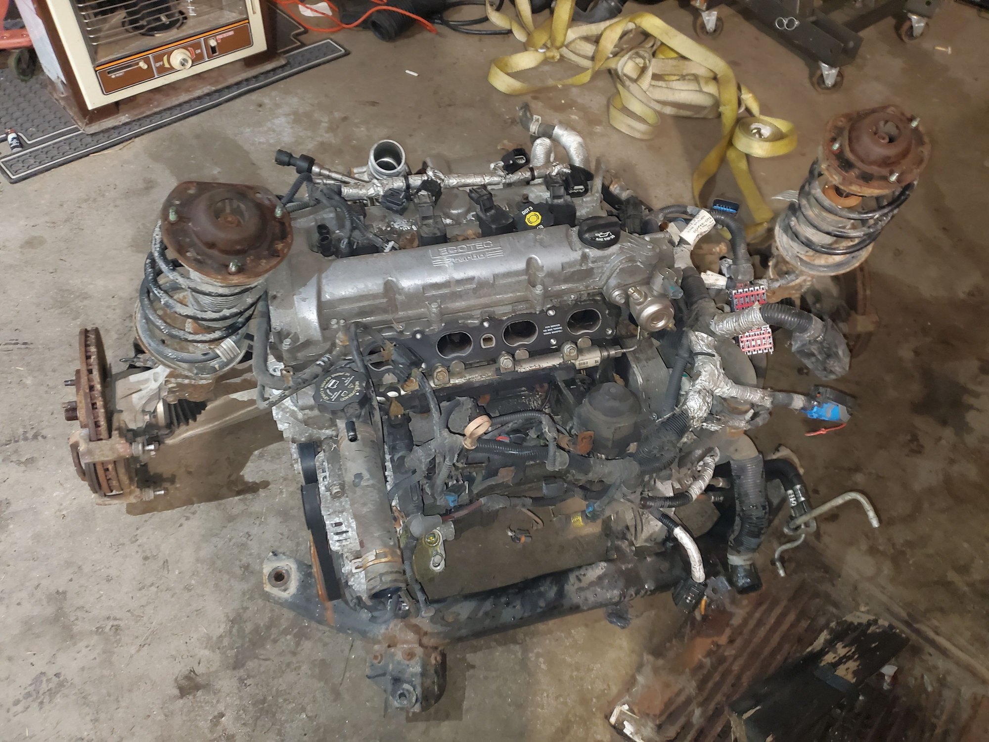

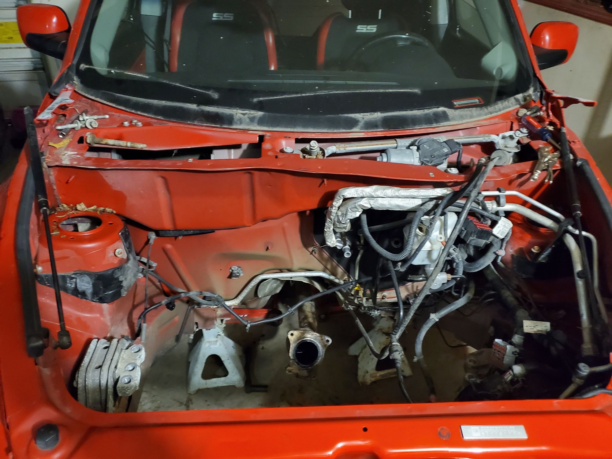

And its out!!! Had 2 guys helping today. Without them this wouldnt be moving very fast at. I'm told I have them for the week. Goal tomorrow is to mate the new motor and get it and the cradle back in the car. question! This car I just found has a catless stainless down pipe. I think it's on factory tune, Do I need a tune for this down pipe?
