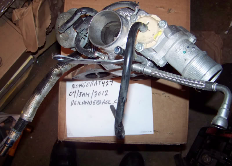

ok....the bypass valve is located on the turbo. take the intake completely off and look down where the intake attaches to the turbo inlet. there is a yellow cover with the three bolts see pic below

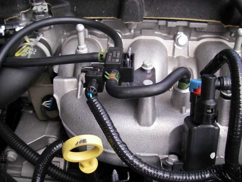

now the bypass valve solenoid is located on the left side of the intake manifold. it has 3 vacuum lines coming in/out of it and there is the bypass valve solenoid vacuum tank located underneath the intake manifold. crate engine depot sells the solenoid...not very expensive but i hate just trying parts to see if that is the problem or not.....maybe try a new one and see if that is the fix
here is what the solenoid looks like......ignore the routing of the vacuum lines...your lines are routed differently
