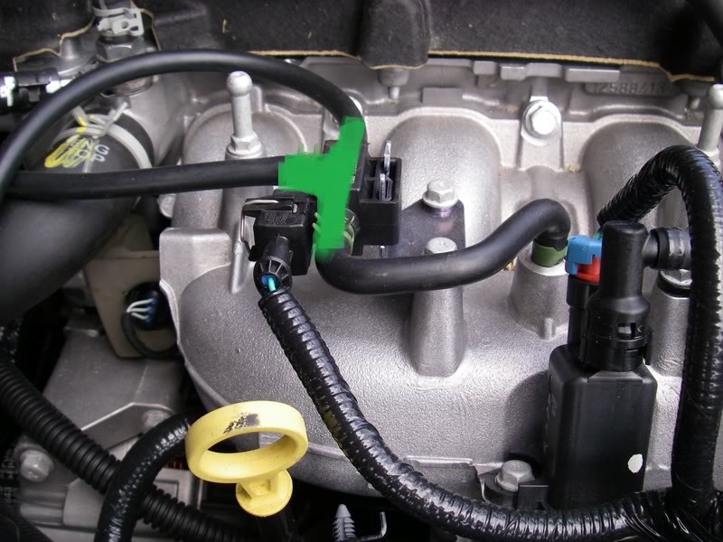

ok first thing i would try and i totally forgot all about this in your case......bypass the solenoid tank by routing the vacuum lines as pictured below. the solenoid tank is located underneath the manifold...the purpose is to store and quickly release vacuum and sometimes this tank does not do so correctly. i have had mine bypassed for over a year now.

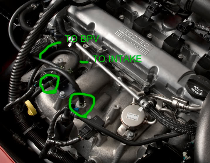

you should be able to bypass the whole solenoid altogether by rerouting the vacuum lines and replacing the solenoid with a t fitting. the vacuum lines and solenoid are supposed to look like the picture below. reroute them to look like the picture above and pull the solenoid and put a t fitting in its place

i would try the vacuum tank bypass first then the vacuum lines will be where the need to be to simply replace the solenoid with a t fitting. long term.....dunno....i would at least replace the faulty solenoid and possibly leave the vacuum tank bypassed

I just bypassed the vacuum tank...(took like 2 mintues)....of coarse...still runs the same.
As far as bypassing the solenoid to see if it's bad or not......
Does this look right?

no place a t fitting where the green marking is
