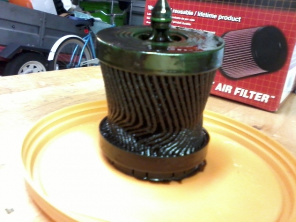

I changed my oil and filter yesterday and this is what it looked like...

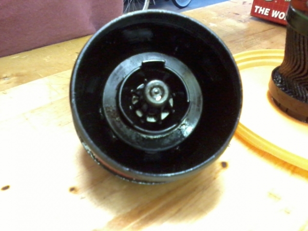

The valve assembly in the cap had separated (I reinserted it)...

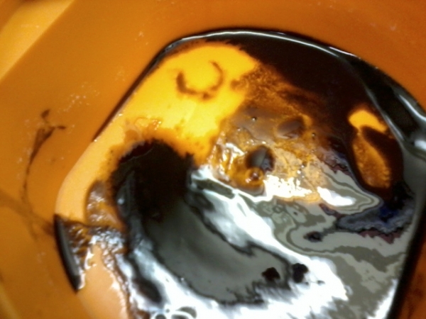

And this is what the oil from it looked like after 9100mi(!) (I drive a lot of highway miles)... the oil monitor was at 13% (Mobil One & Filter)...
It seems that the filter was unable to do its job from the get-go. As the cap (anti-drainback?) valve was popped out of its seat, it allowed the oil to drain back down into the crankcase. This would have the engine starved for oil until pressure built up, like when happens when you change your oil and start it for the first time afterwards.

What I want to stress about my prior post is, be CAREFUL when you screw in your oil filter. According to my past experience, you should be able to 'hand-screw' the cap to within a few last threads and then tighten with a wrench. Seeing what happened to my filter brings back the memory of having to wrench it most all the way down on the prior oil change. It must have come apart during installation and I did not realize it (the pictures speak for themselves).
Lastly, although I have been relying on the oil monitor system, I did not realize that my mileage had passed 9000mi within the last 4 months. Mobil 1 has an extended protection oil, guaranteed to 15,000mi, but I'm not quite sure for a turbo motor, that would be good.
