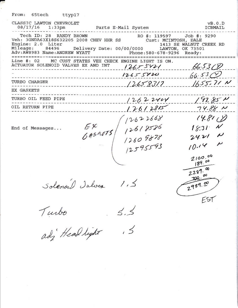

It happened again yesterday. Passed a car on a two-lane highway and all went well. Went to pass another and didn't feel any boost so I backed off. No CEL yet. Then on the Interstate I pulled out to pass a semi and pop, CEL is back on. Car ran fine just no boost. Took it to Chevrolet today to have the code checked and was told the turbo is bad List of parts include "actuator solenoid valves ex and int," turbo, oil feed pipe and oil return pipe along with misc gaskets - $2990 est cost.
I had planned on keeping the car probably until I die. Comfortable, gets good gas mileage, hauls everything I need to haul, and fits in my garage. 2008 HHR SS currently has 84000 miles and I only drive it about 5000 miles a year.

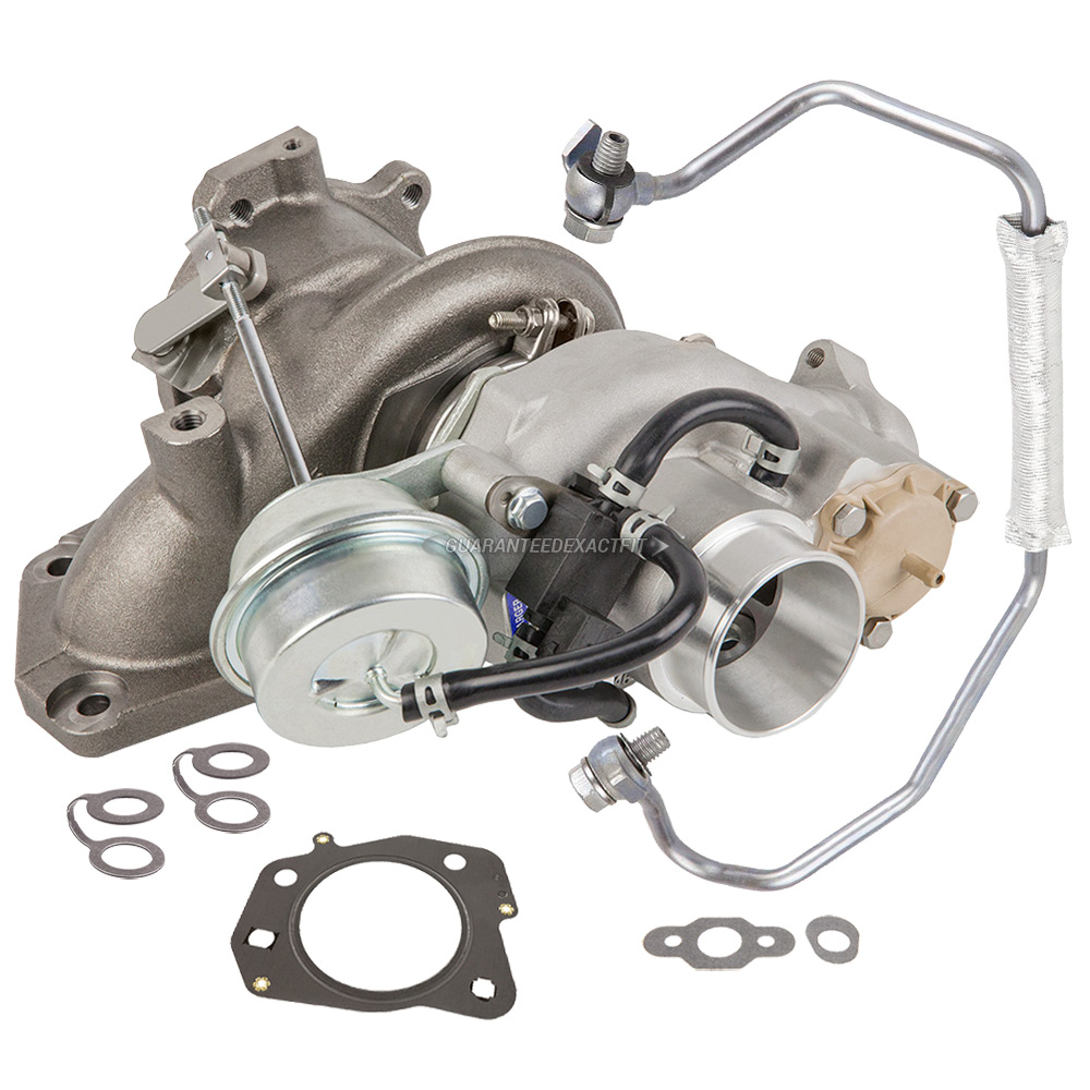

I have to admit I'm an old geezer. I'm from the V8/carburetor days and all the pieces/parts of turbos are foreign to me. I'm not up on all the terminology. Based on the written estimate I was given some kits from turbochargepros.com run around $900 and seem to include everything except the actuator solenoids which Chevy quoted at $67 each.
ChevroletÂ*HHRÂ*Turbocharger and Installation Accessory Kit from Turbocharger pros
Are these guys any good, reliable?
Not looking for a hot rod, just dependable transportation that I can feel safe on the road with and use the boost when needed.
From looking at their estimate, I have zero faith that they even know what's wrong with your car. They want to replace both Camshaft Position Actuator Solenoid Valves, which have nothing to do with an overboosting turbocharger. They also want to replace 4 exhaust gaskets when there are only 2 on the turbo.

The dealer has to sell you a new turbo because they cannot get the boost control solenoid any other way, it is not available from GM as a standalone anymore.
