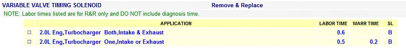

I just noticed they want 1.5 hours for the VVT valves.
The extra exhaust gaskets are the air gaskets.
From Mitchell: Include R&R of air filter. Looks like they don't know how to read the flat rate book. That labor is almost right for the Camshaft Position SENSORS. And no reason given for the work. I don't trust them, they are throwing parts at your car.

Update: Took the HHR to an independent and he's replacing just the solenoids - says everything else is fine. $360 with oil change vs $3000 from Chevrolet.

You posted the prices; $66.53 each. Parts $133.06, labor for both 1.1 hours.
Oil changes with M1 probably around $50.
If you meant to include the 2 turbo parts that's about $100 according to the links posted.
That makes a difference, but you said "just the solenoids" which I took to mean the VVT valves., and we have heard of shops charging that much. I was advising to look closely at the estimate.
