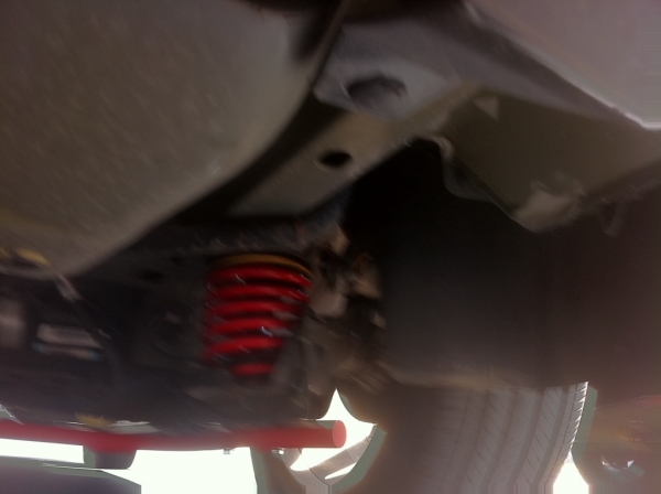

So I had a set of Pedders spring and an OTTP hardcore rear sway bar proffesionaly installed on my 2010 HHR SS 5 speed at a Pedders dealer about a week ago. I am happy with the ride and stance, but now I have a clunking sound coming from the passenger side rear of the car over bigger bumps but not all (note..the oem springs did not produce any clunking noise and the car only has 7000 miles). I took the car back to the shop for trouble shooting and this is where I am at. The noise happened with the sway bar off so it is not the bar, The shop put in two new pedders springs in the rear but now the clunking is worse and happens over most bumps. The tech told me he was out of ideas for fixing the noise. Needless to say I am not happy with that. I am taking the car in to the shop one last time this Friday to have my original rear pedders put back on. I was told to bring my oem springs so they could put them on to see what might be happening (again this never happened with the oem springs) The manager of the shop even spoke with Pete at Pedders and he also had no idea.
If anyone has any suggestions or insight as to what might be happening, please let me know. Any comments or suggestions are welcomed as I am frustrated at this point and considering returning the Pedders springs and returning to the stock oem springs.

They might have installed them upside down.. it might be coilbind that youre hearing.. take a picture of that side with the car on the ground and post

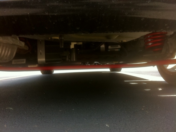

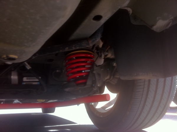

Here are some pics (taken on cell phone). You wouldn't think a pro shop would install them upside down, but who knows.

X 3, you've got one installed upside down, there is top and a bottom to any spring. Really surprised that Pedders doesn't indicate the proper orientation or provide instructions.

Ill look at the pic when i get home my work blocks it.... tell them to swap the clunking spring to flip it

Looking at your pics, thats how mine are installed and I have no issues

Yeah i just saw the pic and they look normal

the spring is beehive shaped....the pointy end is the top. If you set it on the ground you will also see that they have a "lean" to them.....they should be installed with pointy end up and leaning towards front of car

Maybe they goofed with this one corner.
