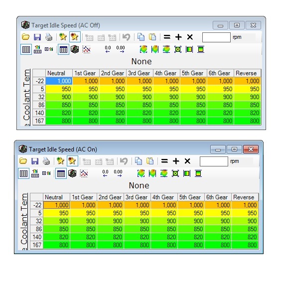

The "tune" has 2 different target idle speed. One with the Air on the other with the Air off. In mine the RPM is the same for both.

These are my 2008 HHR SS stock idle tables.
I can tell you that on every other car/truck I have programmed they are indeed different. Again the program for a LNF is a while lot different than anything else.

It must be the tune then because my idle doesn't go up at all when the AC is turned on. According to the scan gauge I'm sitting at about 780-800 rpm with the AC off and 790-810 with it on. That seems pretty sloppy on the part of whoever did the tune.
