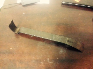

Here's the Danby version, about 10 bucks if you haven't got one lying around. I believe it's a "carpenters" prybar because of the nail removers in it. Who knows, it works for me.
Since I don't want anyone "prying" on there cam gears. Let me explain, I'm using the width of the bar to hold the gears. It needs to be put in at a slight angle. If you notice, it gets wider at the ends. I just insert and then tap it in until it wedges tight between the two gears. I would've taken a pic with it on the gears but all my heads are in pieces.
