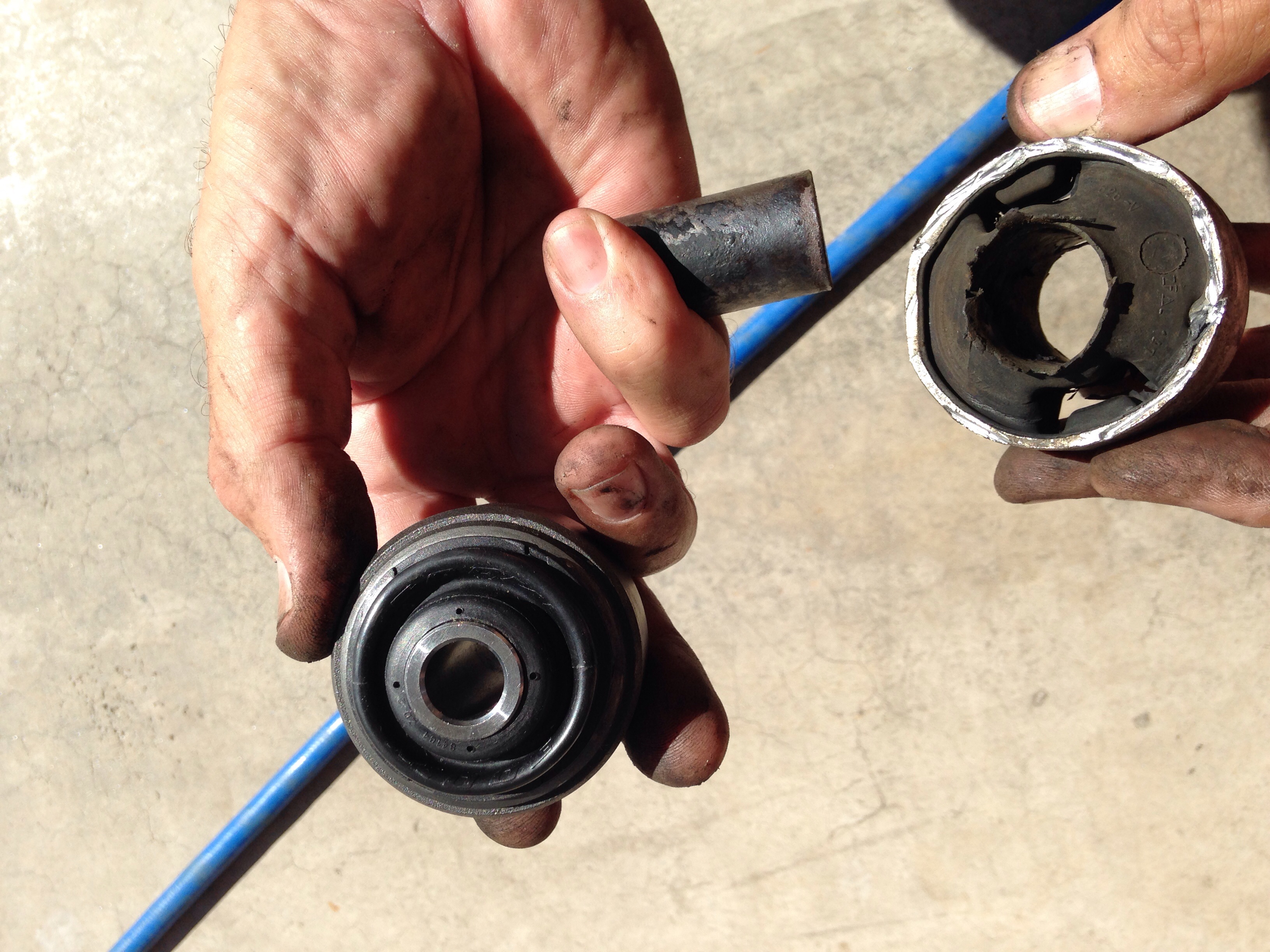

I did suggest intermediate steering shaft , but it could be the LCA rear bushings, I know you just changed them , but the new style problem solvers are so much more firm as the are like a bearing or heim joint

Oldblue, not sure what you mean about the LCA bushings, they actually did not look like the one i the pic, they were smooth rubber, no rolled rubber like the one in the pic, if that matters!

Check in this link the problem solver bushing are no longer just a rubber bushing
MOOG-K200792 - Front Lower Control Arm Bushing - Rear Arm to Frame made by MOOG

i got moog LCA bushing K6698 as its for the SS
