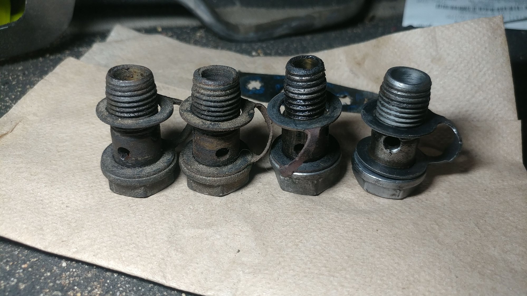

Got 3/4 of the exhaust studs out. Going to dealership for the one that was stripped.
Does anyone happen to have a part # for the oil and coolant banjo bolts that go into the turbo?
I would like to replace them while I swap the turbo if the dealership has them

The gaskets are in your thread that I linked to. You're replacing the bolts too? If you're going to the dealer they have the part numbers.

If you're going to the dealer parts department, just give them your VIN and they can tell you with great certainty what the correct P/N is.
