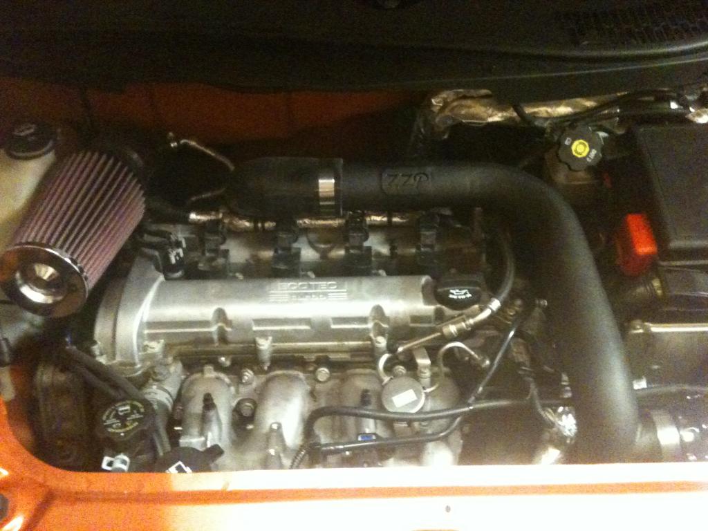

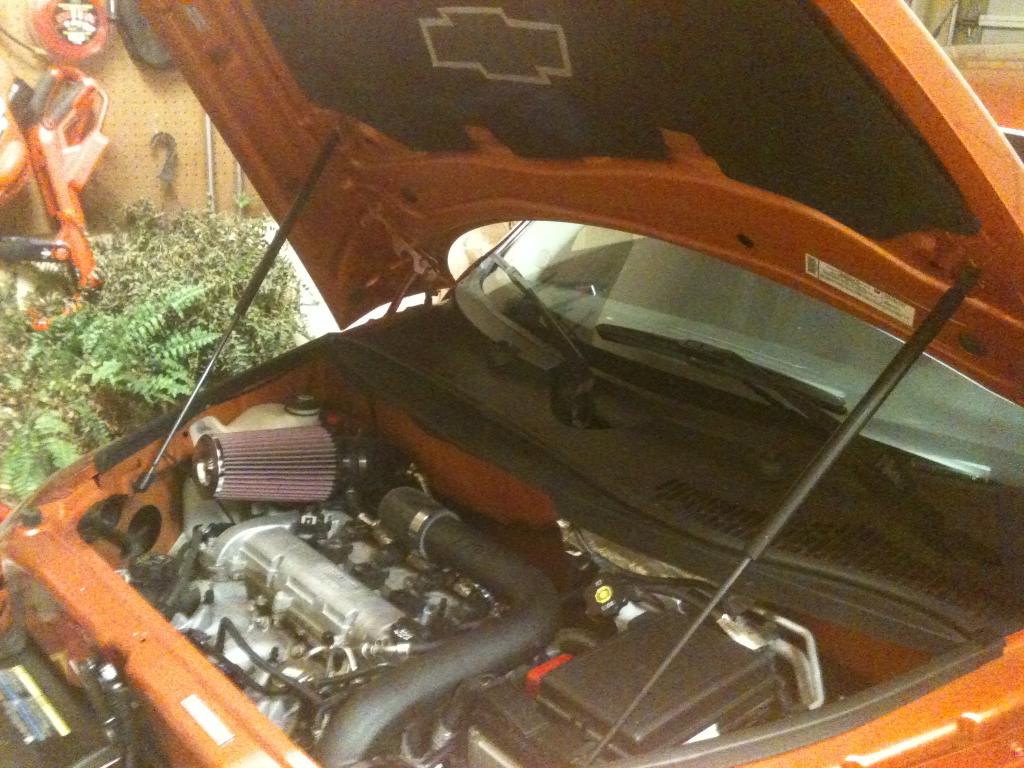

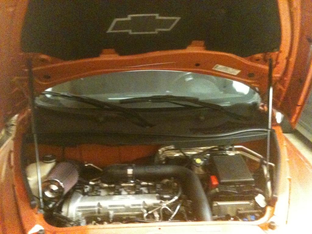

Sorry for crappy iphone pictures Name:  turboinstall2.jpeg

Old Feb 23, 2015 | 09:48 AM
Posts: 40,083
Before you tune it , I'd close in the air filter and draw air in from the outer fender area and not the hot under hood air.
Then get the tune.

Old Feb 23, 2015 | 11:47 AM
XtremeSS's Avatar
Joined: 02-13-2010
Posts: 698
From: HuskerNation
Then get the tune.
He is running the MAF relocate. It relocates the MAF sensor and lower MAP sensor to the vertical portion of the cold side charge pipe right befor the throttle body. With this setup, warmer air drawn from the filter is not much of a factor as the MAF will not see the condition of that air. It only see the condition of the air after the intercooler. Also known as "blow through MAF".
Old Feb 23, 2015 | 05:47 PM
Posts: 40,083
Well alrighty then, now you two claim warm air is just fine? Sure contradicts the theory of s CAI setup, I guess 45 years of racing didn't teach me anything, even if the cone filter was simply boxed and the cold air hole connected to it would be an improvement IMHO.

Old Feb 23, 2015 | 08:12 PM
  #26
XtremeSS's Avatar
Joined: 02-13-2010
Posts: 698
From: HuskerNation
Considering the fastest and highest hp LNF's use this setup, yes it is fine. No improvement to inlet air needed. Best way to improve IAT is at the IC.
Old Feb 24, 2015 | 07:31 AM
  #27
mississippisunburst's Avatar
Joined: 10-20-2011
Posts: 203
From: Nesbit, Ms
All the air is cold for now, hasn't been above freezing all week!!!!!
This is what the kit came with. I questioned it too but zzp says it's the way to go. I'm trusting the highest horsepower (710) lnf world record holders.
