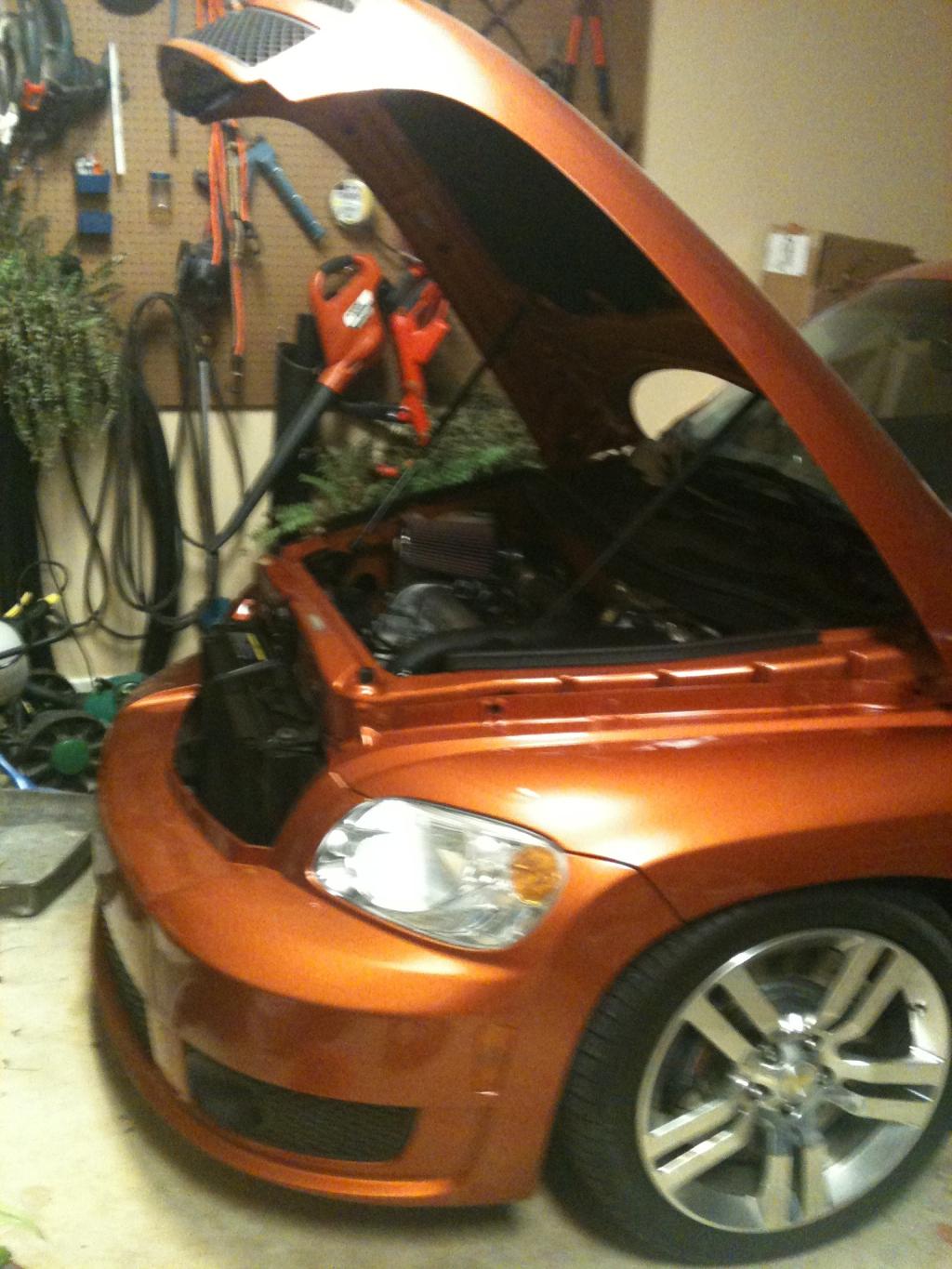

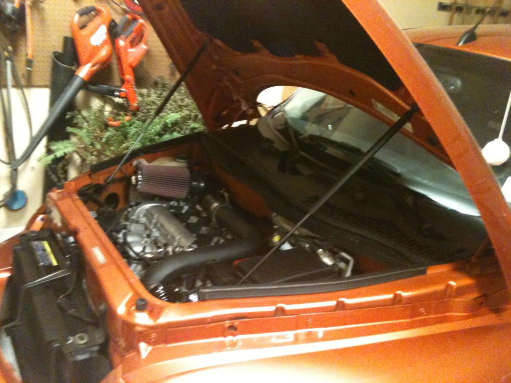

Weather won't cooperate. Can't test, can't tune. Only detail, detail, detail. I hope it will pay off come show season.

All installed and it runs with no codes. The tune is way off, boost comes on WAY too early and WAY too hard, it WILL break something like this. It's going to the local tuning shop as soon as our weather comes around and the city fixes the potholes. Three straight weeks of ice has taken it's toll here. (it did light the tires at 60 mph on the first test hit)
