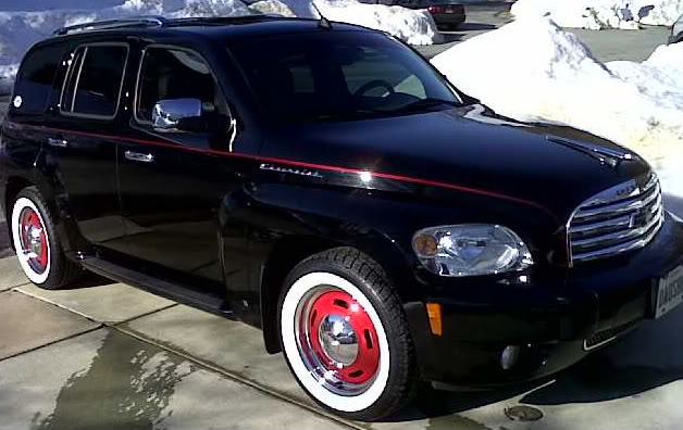

IF they were safe to drive, IF they were legal, they would look nice on a HRR with an actual
retro panel look, though here are some examples:

Old Oct 30, 2016 | 12:30 PM
Posts: 40,083
You know I like two of those red rims sets!!
