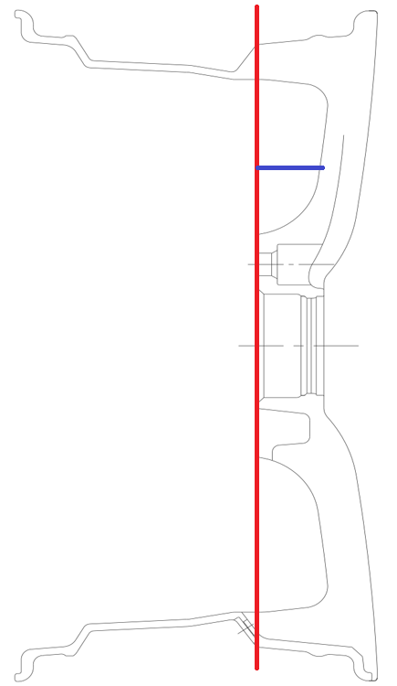

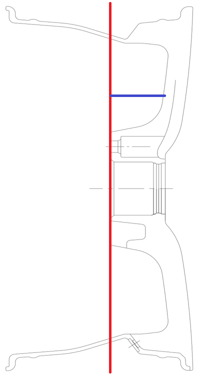

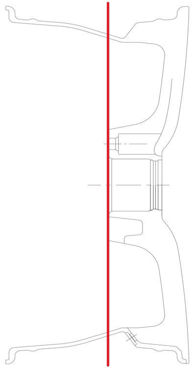

To help visualize what I said above, here are some examples of the insides of wheels.
This one is for a 17x8 wheel but the hub area is the point of the example. This is most likely too short to clear the calipers. You can see that the spokes are not that far away from the hub area.
Now look at this image. You can see that the spokes are much further out then they were on the 17s. These are 18x8. These have a better chance of fitting.
Both of those are the profiles for this rim
This is my current 18x8 Niches.
As you can see in the pics, from the front they look like they have the same profile in relation to the rim and the hub. But they don't on the back side. Mine are like the first image. What makes this even harder is that mine have a +35 offset vs the +40 offset of the second profile image. So even though a rim has more offset does not mean it will fit vs one with less.

I took it a step further to illustrate the issue.
The area to the right and left of the blue line is the issue. Ignore the offset differences here. The profile is a bigger issue.
