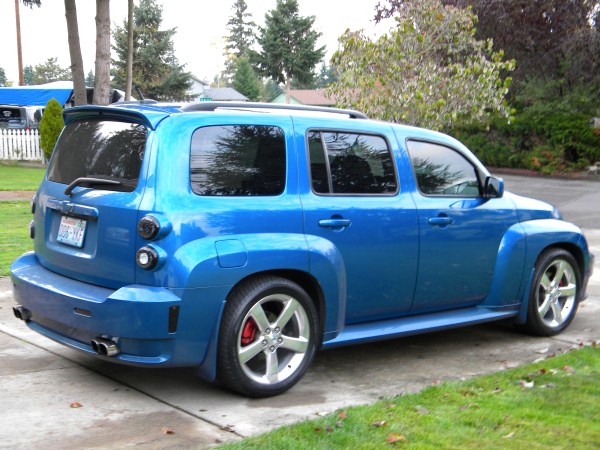

Got some G-max tires today they will look good on the Solstice wheels . So while all the spacer experts are assembled give me a recomendation which ones to buy, front only Capp02 ? BTW your panel looks bit chin, have you entered it in the little monthly HHR feature, looks done unless your SCing it.

Thanks ANOKAHHR, they worked out good H&R makes them hub and wheel centric. Lets see them panels of yours ??https://www.chevyhhr.net/forums/show....php?t=3033%27

ANOKAHHR's Avatar
Joined: 03-22-2008
Posts: 116
From: Anoka,mn
SSfan you can check out my panels in my gallery. Pictures were taken about three years ago and I changed wheels this winter. 17.5 x17 DxR WITH 235X45X17's on the HHR and 15x8 CRAGAR SS with 275x15 on rear and 15x6 with 215x65 on front of 49 WILLYS. Will post pictures when snow leaves and wheels are mounted.
