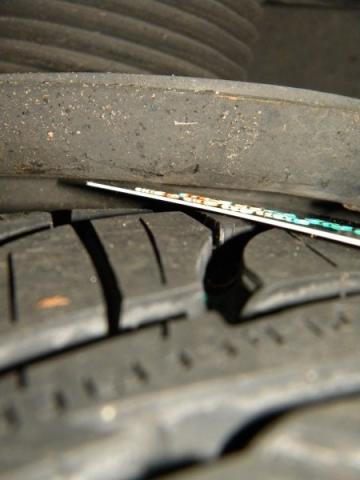

Hey Stan welcome aboard, way to go with a first question, besides when do you change your oil, what size tire, always brings lots of responces. I concur with those who say 26" is it, for height but there is room for argument on the width, these are 255 x40x18 and there is very little clearance anywhere. they are 26 tall and room for a credit card left.
