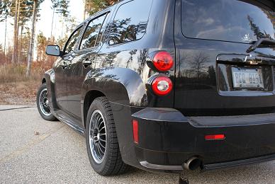

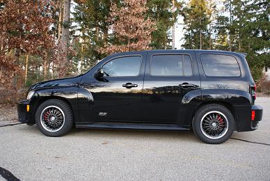

Got em on today, not bad looking.... at least for winter
