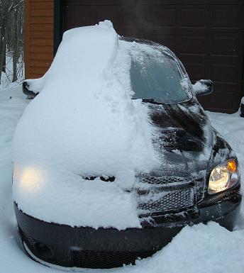

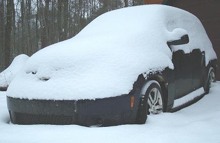

md-HHR I'll see your snow pics and raise you:
Actually with the stock Michelins, it wasn't terrible, I never got stuck with record snows and pushed snow with the air dam many times.
I really want really good snow performance though.
