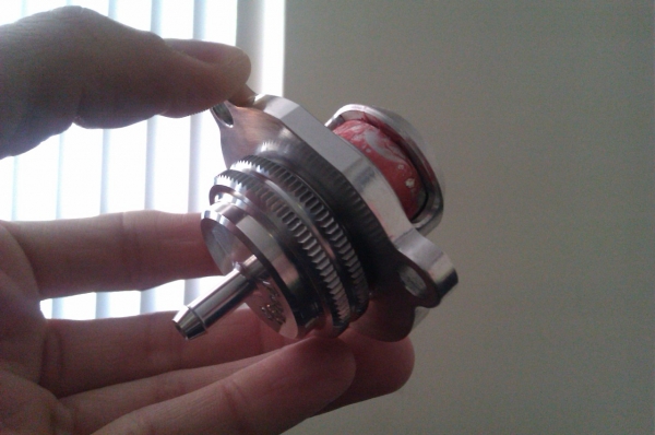

Got my valve in. Looks and feels way better than the stock valve. So far so good no problems. I did notice it is more quiet with the air lid on, but with the air lid off it sounds a whole lot better than stock. It does change the sound but in a good way.

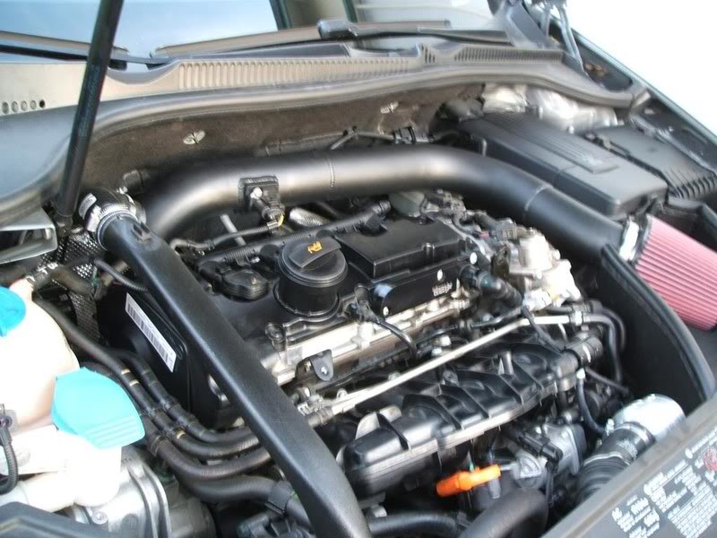

can anybody see the big ass forge diverter i had on my last car:
