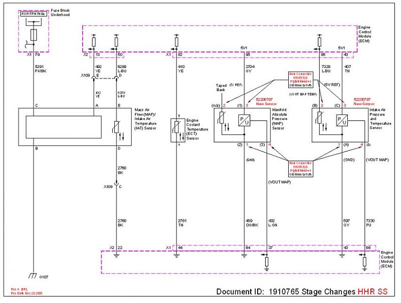

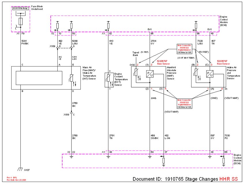

Updated Document ID: 1910765 for stage kit.
Look this over and make sure it is correct with the changes that need to made for the HHR wiring.
