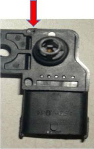

I will be ordereing the plug and play plug in kit so I am assuming I still will have to dealer perform the Tmap mod below?
for some reason they show the tmap with boss but not with the boss removed
So it sounds like The dealer has to perform the tmap boss mod and also put something like a heater hose around the wiring where it would rub on the pipe or have the dealer create something like SS fans dealer did?????

A technician may comment that the TMAP interferes with the CAC pipe when performing the Stage I update kit on a 2008-09 HHR SS.
RECOMMENDATION/INSTRUCTIONS:
The sensor will require modification before assembly or leaks may occur. Engineering is currently reviewing this concern and a service procedure has been developed until the parts can be updated. Following the steps shown in the photographs will prevent any concerns when mounting the TMAP to the CAC pipe. As shown below the boss must be removed to prevent interference with the alignment tab on the CAC pipe; carefully clearance the boss (as shown) until the TMAP will mount flush.
Boss shown in place.__________________Boss shown removed not shown.

here is plan purchase the plug an play gmtu kit for Crate engine depot
show service writer pics and info from above showing that the boss has to be removed
and to see if they can fab something up like ss fan has
Drop car off and hope for the best
