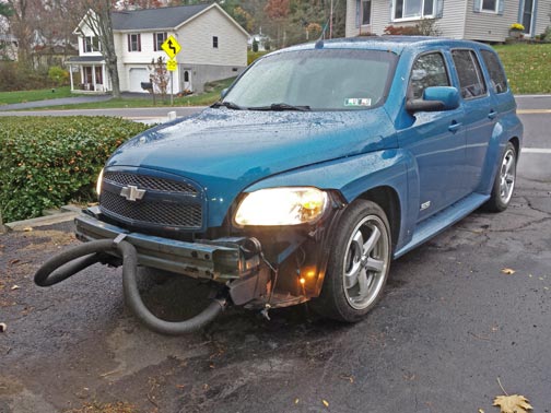

Just for comedic effect:
Below is a replacement intercooler from Shop-Vac. I needed to move my car a few hundred yards so my Shop-Vac hose was the perfect fit. A little gorilla tape, and away I went.

OK, slightly Off Topic, but who wants to bet me that some Honda guy will see that "Totally Cool Shop-Vac® Intercooler" here, fit it up to a Civic with an e-Bay "Electric Turbo Kit"...and suddenly see 400HP on a chassis dyno...when the V-TEC kicks in yo!
