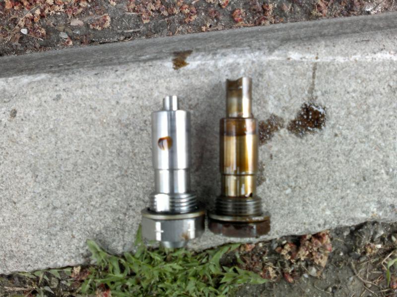

Ok, so I tore the side and valve cover back off this weekend, and reset everything the right way. Had to buy another cam chain tensioner because those things are flat out junk and most times once you set it, it can't be locked back down cause the small ***** inside that locks it breaks.but anyway, got everything back together and drive around a while letting the car get to operating temp a couple different times. Everything is good to go I guess. The only code I'm getting now is the evap system control valve, or evap purge valve. What might this hurt if not fixed? Thank you everyone for the input you had. I appreciate the help.

So which tensioner did you get?the new style has the thicker head with the hump, in the left in this picture

thank you all again for all the help. I bought the newer onne on the left, but if you year it down, the locking mechanism inside is only a small piece of weld or solder. Seems like every one separates as soon as it is unlocked. Couldnt be happier sit the way it runs, and since Autozone swapped it for a free one, I'll eat the money. Lol. But i saw another thread somewhere that showed three different tensioners. I think clouds made the third. Its supposedly the best. Anyhow, I do a lot of "parts that can wait" buying from rockauto, so I'll check into the purge valve. But i didnt know there are two on the car? I know the one on the valve cover. Where is the other? Right now my phone is being really slow so I'm not able do look into it much at the moment. But I want everyone to know I really appreciate the help with everything. I hate letting someone else turn wrenches on my motor, some shops know how to keep you coming back you know. And i will never use the dealership for service cause I'll never own a brand new car.
