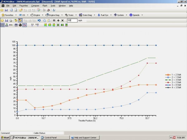

Here are 2 HPTuner charts with what's going on, when the shifter is placed into,
TOW mode, the intermediate, or "I" position…
As you can see in the chart, 4th gear is locked out, unless you reach 318mph…
And with 1st, if you put all zeros, for the 1 to 2, & the 2 to 1 rows, you can lock out
1st, for winter driving, when you want to start out in 2nd gear.
So, with HPTuner you can mod this table to suit your driving style, or race track,
to create your own mode.
Track mode.
Race mode.
Winter mode.
Fun mode.
ect, ect.
You can set this table for higher shift points, for drag racing.
You can set this table to start in 2nd gear, for winter driving.
